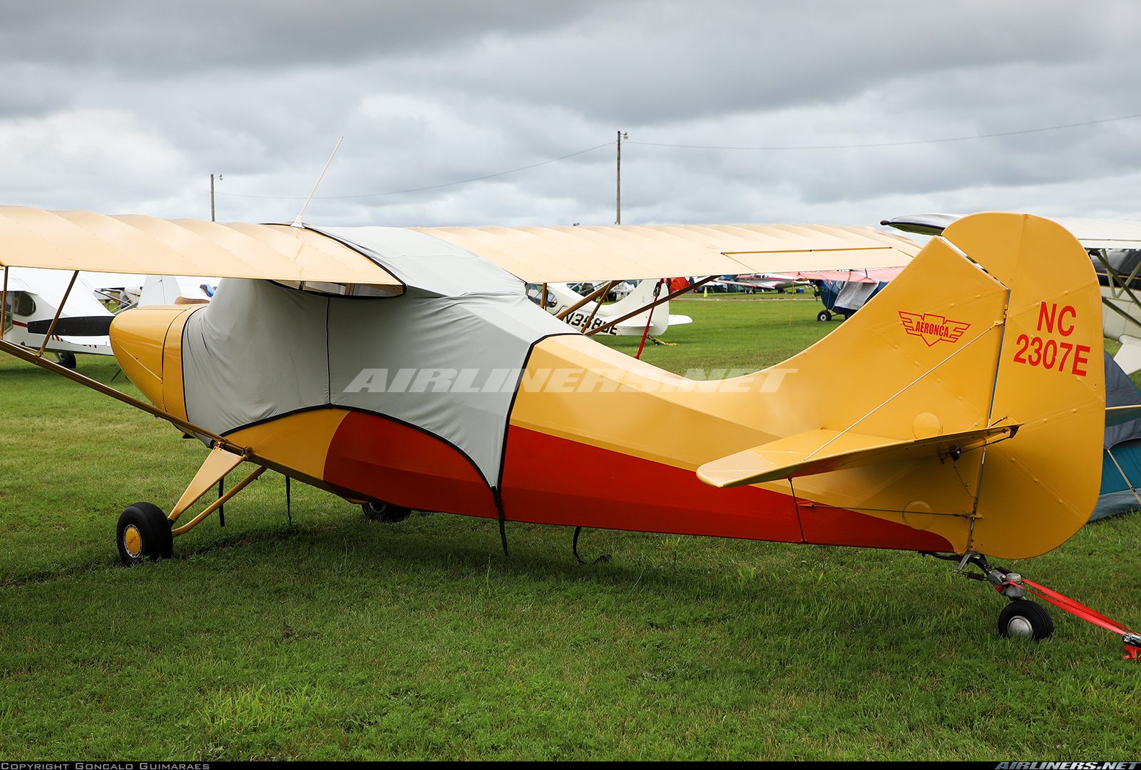

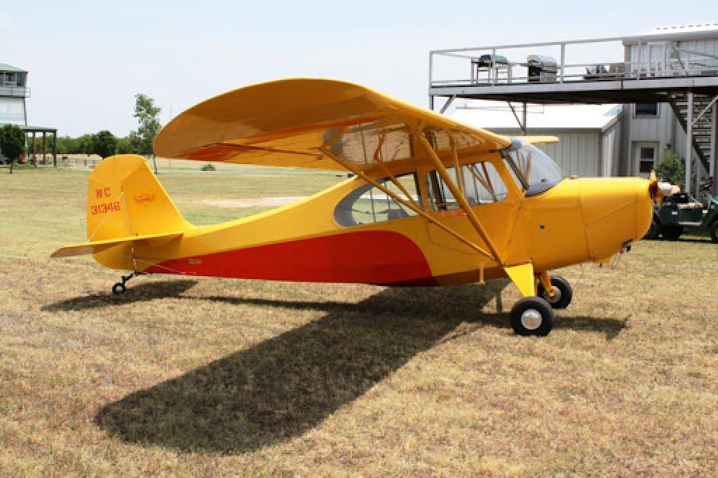

Ordered a cowl today. Plan to build this fuselage with the dorsal fin modification that should help with adverse yaw. Been looking on airliners.net for another paint scheme but thinking I will stay with the yellow/orange scheme. Here are both fin types, apparently the bigger fin allows for increased horsepower on the full scale.
AKNick
My coworker was looking at the full scale champ and saw that with a newer model they made with a bigger engine had this already incorporated into the design. The owner got the drawings from champ and essentially changed his type certificate to the newer model based on this. So makes sense!
AKNick
Any change you can get a copy of the drawing? That would be a huge help.
I'll try and see if he has a photo of the drawing.
Tried to do some of my own research, I think it's based off the Champion Clamp-on Dorsal Fin Kit 178.
If you look up the TCDS on the Champ you'll see in note 4 the required service letters (13/14/15/56) to convert a 7AC champ to another model like the 7DC or 7CCM
It was under those Service Letters I found the need to use a clamp on dorsal fin (gets covered).
Later model champs already have this incorporated, so finding those model designations would help (7DC/7CCM/7GC)
