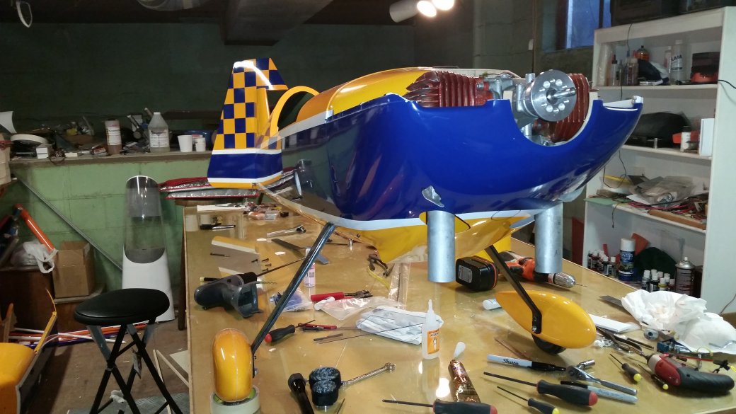

Didnt get as much done tonite as I thought I would..... Lower back was starting to ache.

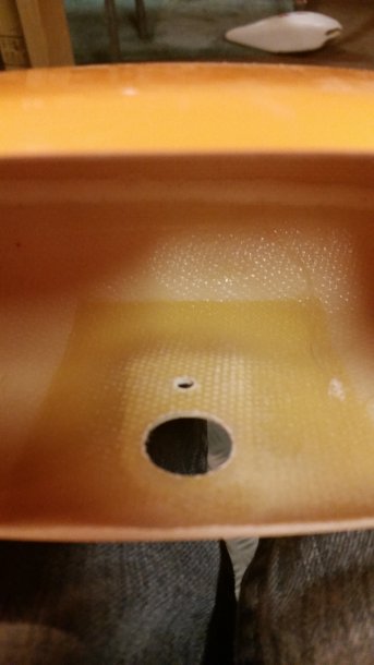

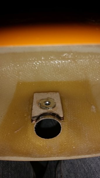

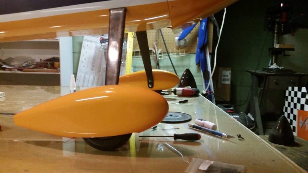

But I did manage to get the wheel pants mounted and the old studs and blind nuts out of the old fuse.

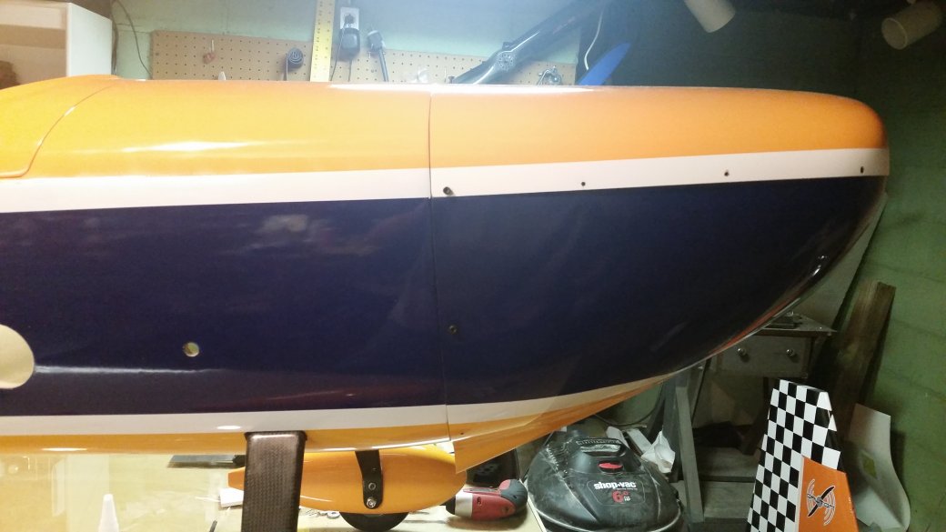

I checked the paint lines as well for the cowl. Cant believe how they match up for being not painted together. The cowl, wheel pants and canopy came first. Then 2-3 months later, came the fuse and hatch.

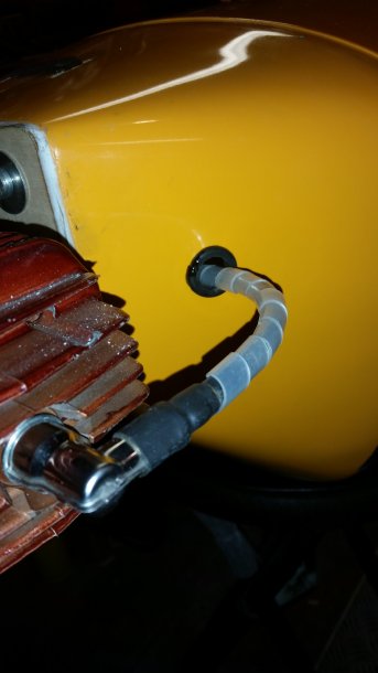

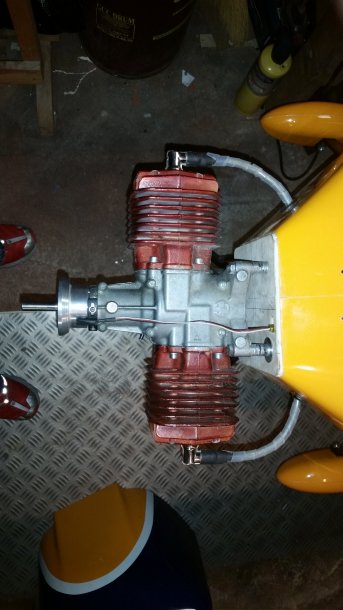

Pics coming soon. Motor is mounted. Working on ignition and an opening for the throttle pushrod. May work on getting the rudder mounted as well. Need to get to the hobby shop to pick up a little bit of wood for making the fuel tank tray and throttle servo mount.

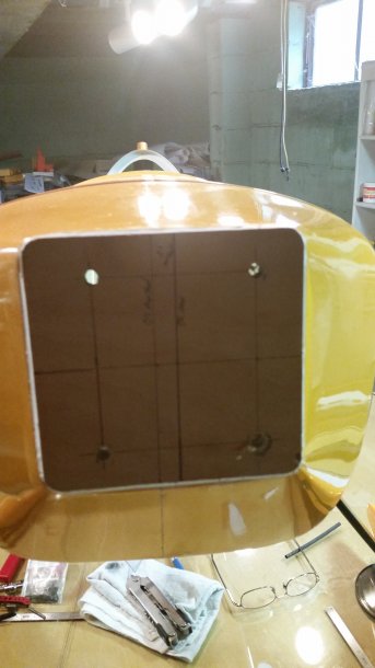

Like I said before, got the engine mounted. 4 holes in the firewall, 4 6mm blind nuts (removed from the previous MX2), some washers for thrust line, ignition mounted/routed, rudder pocket hinges glued up and rudder mounted.

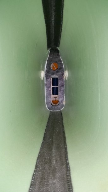

Uh ohhh!! What is this?? Hope to get my TDRC order this week, so I can finish things up. Baffling is next, and then the canopy, tomorrow nite. With good hopes of a Sat remaiden.....
