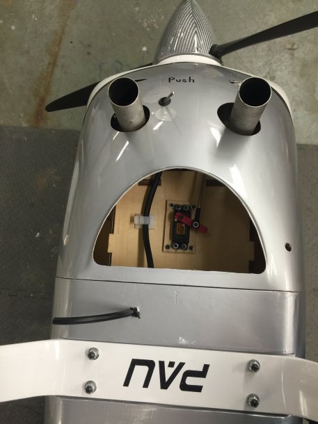

It's good BUT you still have to use the 1:3 ratio with yours it's still 1:1.
I know my H9 Sukhoi does not have 3:1. In fact I'm sure my cowl exit is less than intake. However it does create a low pressure zone and pulls air out. I just baffle the engine and that was it. My last flight on wed had a peak temp on a long full power Upline of 287F. 3:1 does not mean the engine will cool properly at all. I have a plane with that and it can get well into the mid 300F range if I didn't baffle it.

I've always ran tuned pipes with very little openings on both my Sukhoi and extras. I think the extras cool easier because of the smaller path for air. The Sukhoi was harder to get it right. Stihl HP ultra oil at 40 something:1. 1.8 gal for each bottle.

I like how clean the cowl is, with no cutouts for the stock noisy "mufflers". The pipe makes more power and is quieter.

I did a split cowl so my exhaust openings are just clearence circles, no slots. Actually I kind of like the sound of the Jtec mufflers and actually get compliments so it sounds like we both have the best setup ;) and 4¢ between us

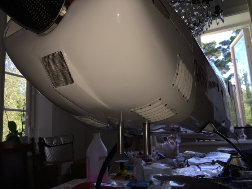

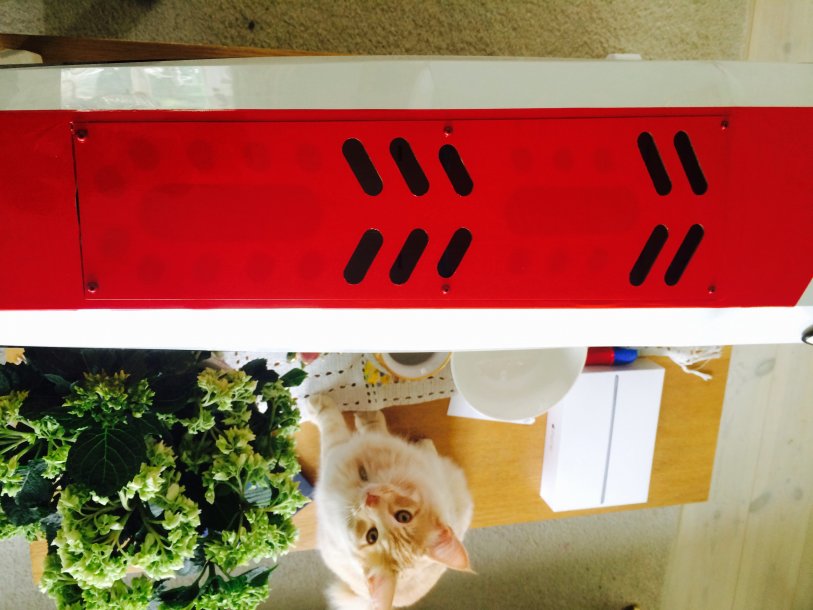

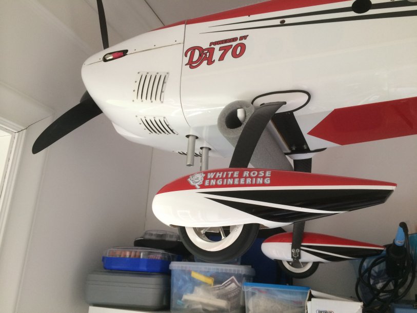

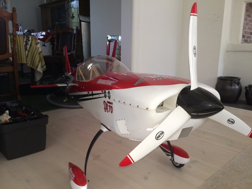

My first gas engine plane. Hoping that the louvers together with the baffled inlet and the cut out for the tunnel is enough. If not there is still room for one more louver in the cowl and more opening holes for the tunnel.
