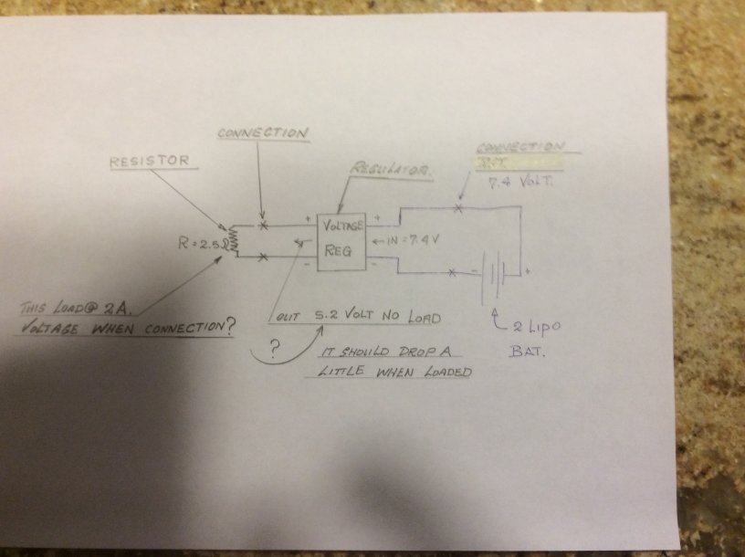

Let's get one thing straight nobody is dum we all have our strong and week points. I am not home right now later will make a sketch and make photo and send to you and hope that helps. When it comes to programing I need all the help I can get.

Oh, thanks snoopy1 !! Yeah, I have a hard time with programming too !! I'm more of a mechanical guy or parts changer sometimes, ha !!
When you connect the resister on left it puts a load on the battery and the regulator and when you do this the voltage will drop from the 5 volts a little if it drops more than 1/2 volt then something needs to changed. Hope this helps you.
