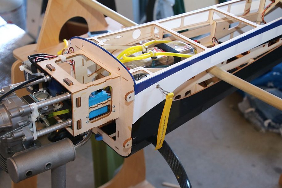

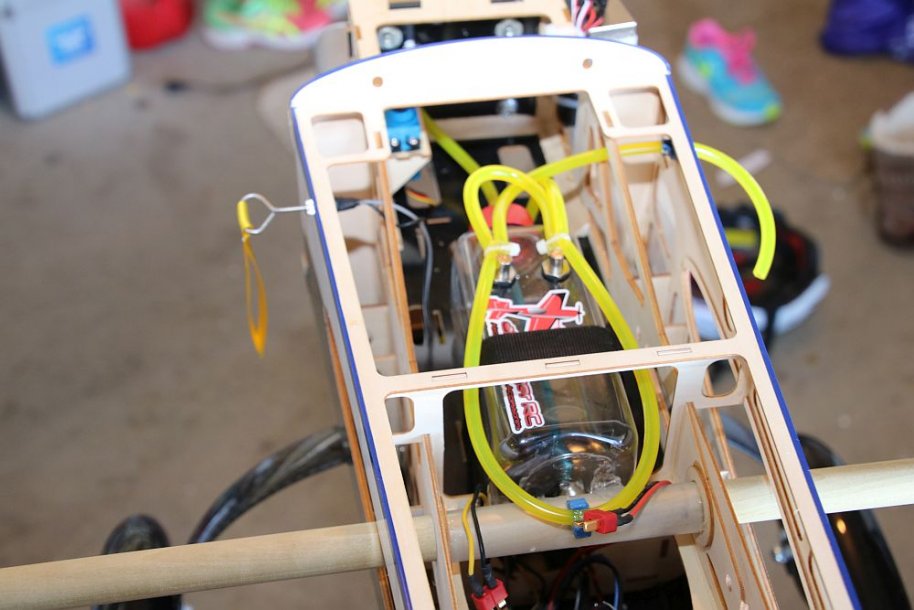

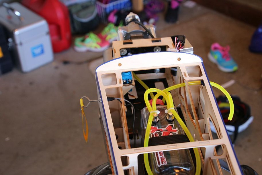

Anyone that's using the Booma pin flag switch I have a question. Just looking at the pictures, I haven't bought one yet, it doesn't look like you could mount it in anything very thick. My fuselage is fully sheeted so it would have to mount into at least 3/32 if not an 1/8". The threads on the end don't look very long. What's been your experience with mounting it.
No problem on my installations. EF edge and Peak/ Acro Extra. Plenty of threads to mount in the fuse.
