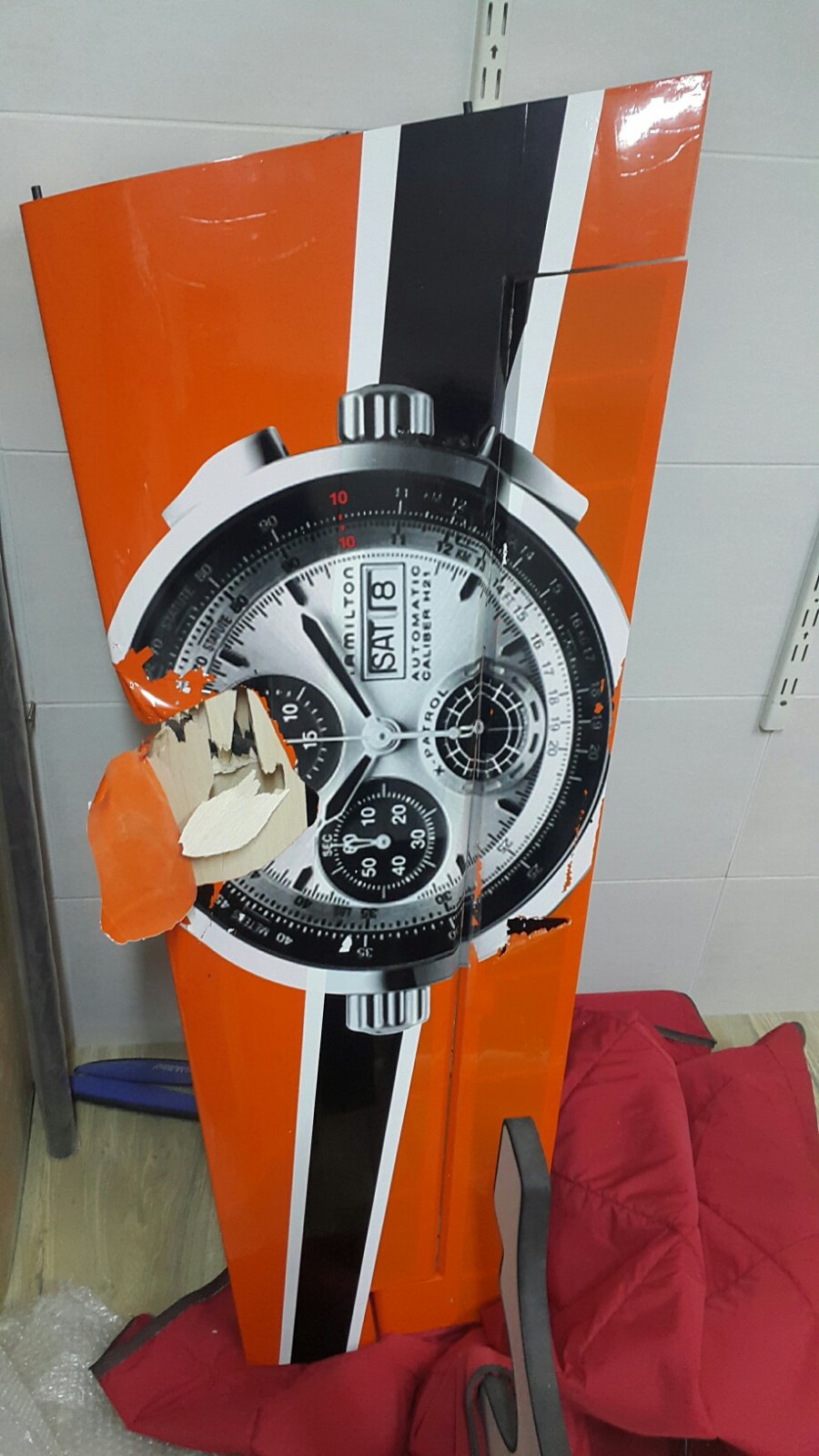

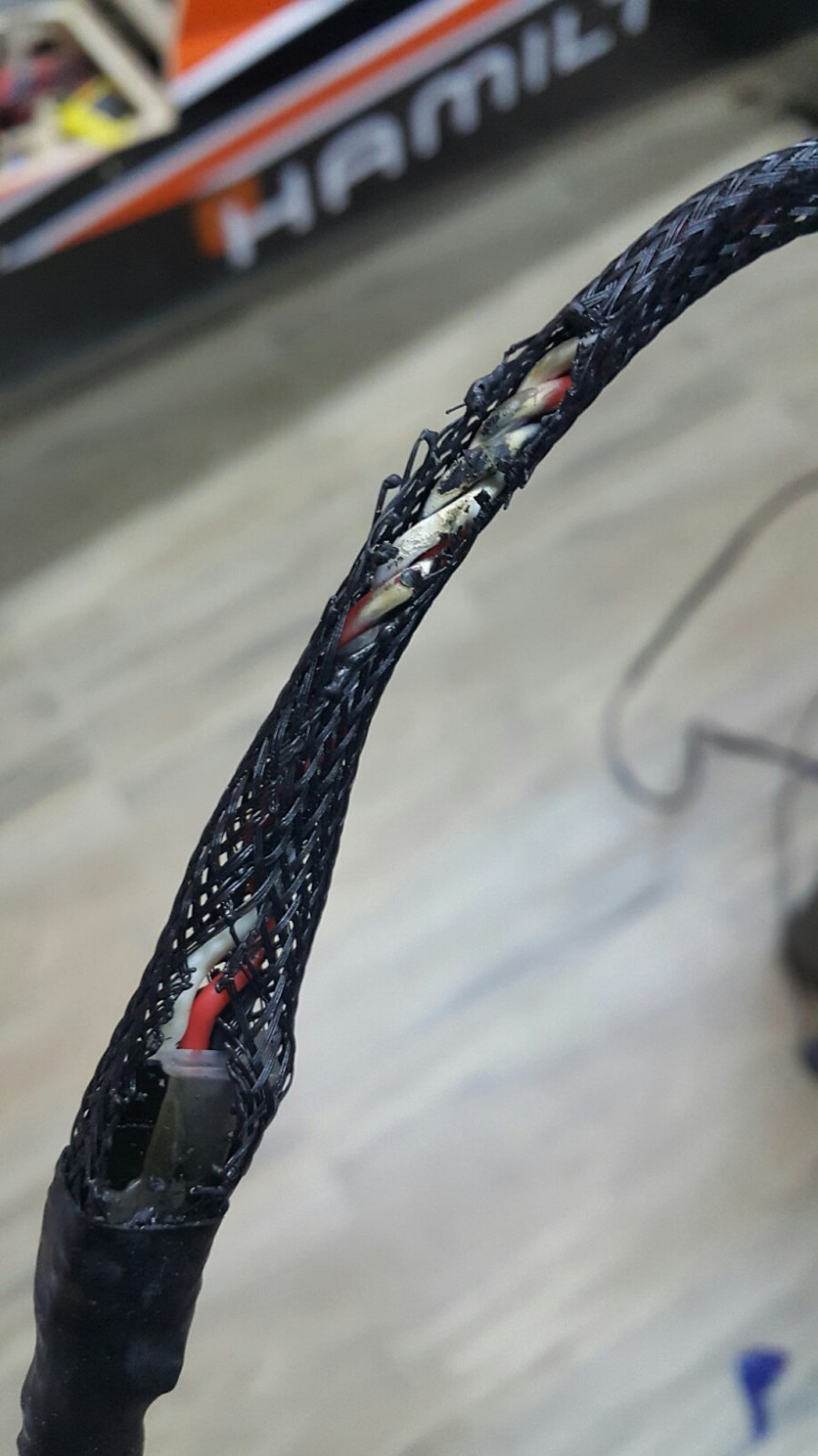

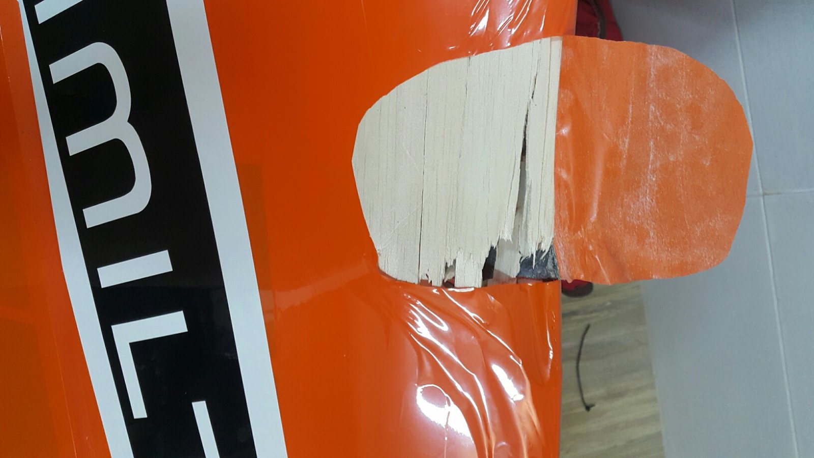

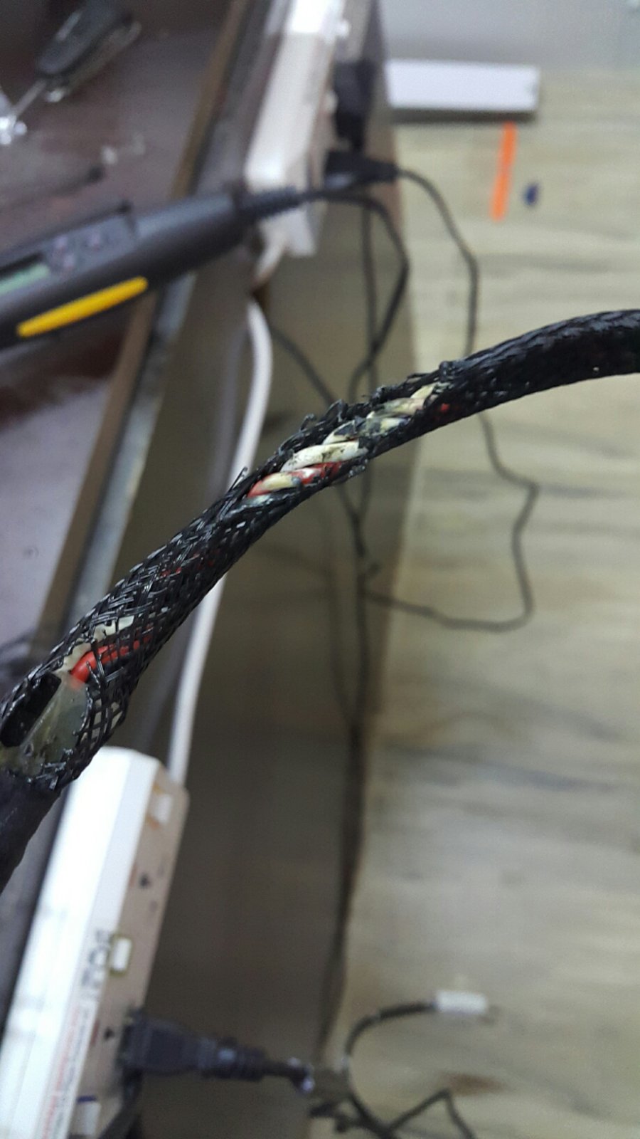

This is what happened with me...running A9..Techaero..savox 1270tgs and pulse lipos
started my dle120 perfectly....engine ran great...everything ran great..as soon as a i takeoff on WOT, the engine misfires badly for about 5 seconds and quits and next thing i know is the plane is into the trees...
luckily the only damage was to the wings which i'll be buying new....
when i opened up everything at home I could see the techaero wire burnt....i'm really confused as to why this happened and it could've been a very huge loss....

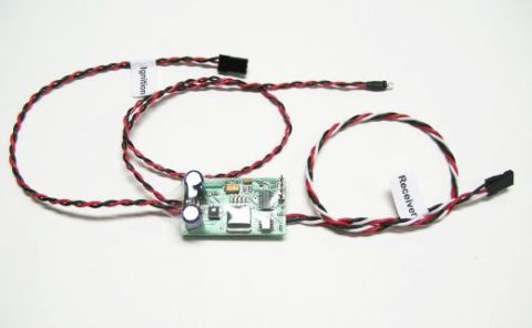

Below is a pic and even though it is from TA's site it is how they come. I would have to say the pic is of wiring going to the TA Rx plug from the Rx and the issue lies within it not the TA. Is this damaged wire the TA Rx plug going to the IBEC, or, from the Rx to TA Rx plug?
