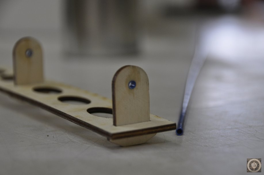

Terry..have you thought about G10 or Type 2 PVC or even Delrin for these parts to eliminated the side thrust vibration wear. I know this is your proto. Just asken.
Terryscustom
Yup, G-10 is heavy so 1/8" birch ply will be plenty strong and check a few pics after this one and you can see that I have a nylon bearing installed in the part you are showing;) All the rest of the parts are made from lite ply with balsa end-caps. Great minds think alike though, thanks for pointing that out!!

I used the 3mm nylon snap-in thrust bearings from McMaster in my Krill wings, with solid CF hinge rods from ACP. The rods are not exactly round so a bit of light sanding was needed to get them to slide through the Krill ailerons, which have plastic/nylon sleeves already in place between the hinge points.
Terryscustom
I have noticed that as well with the solid carbon rods (like the one I used in my test dummy). They have a surface serration sort of from the mfg. process. The round carbon rods that have a hole in the middle are more of a machined smooth outside finish which is another reason I will be going that route. On TheLAW's hempel cub he used 1/8" rods which are nice but it has brass bushings so the bushings got sloppy and I had to switch to a rod that was a few thousandths larger. Kinda excited about the high quality rods with low wear bushings:)

Got my delrin bearing material today.....BAD ASS stuff, it's going to be great. However, the tolerance on the carbon tube was too tight so I had to place an order for some different carbon rods that will give about .007 clearance. With that tight of a clearance I will also be using shorter sections of the bearing stock instead of full length bearing sleeve throughout the assembly. I do have some carbon rods on hand that give a .014" tolerance but I think a little tighter will be good.
