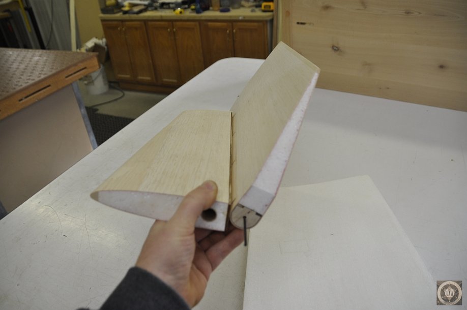

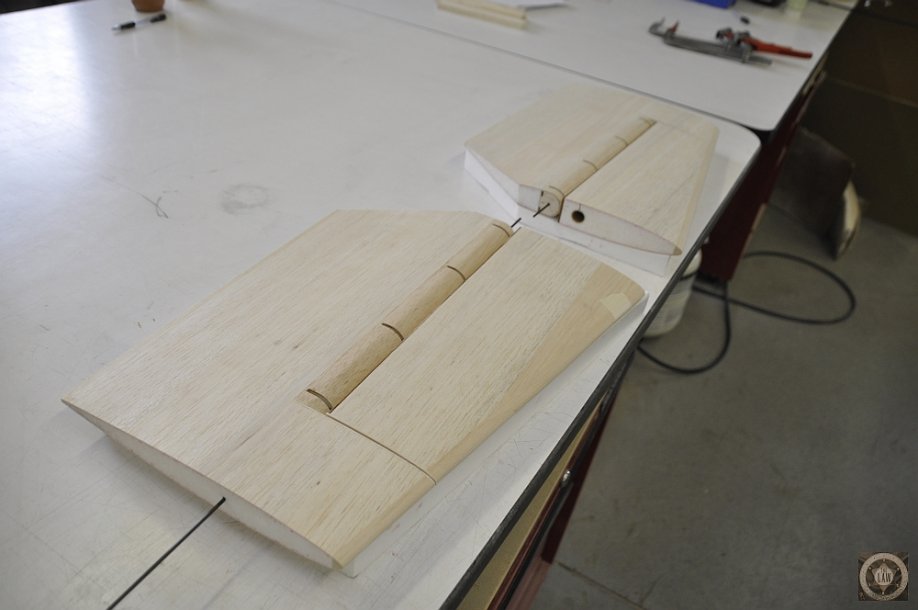

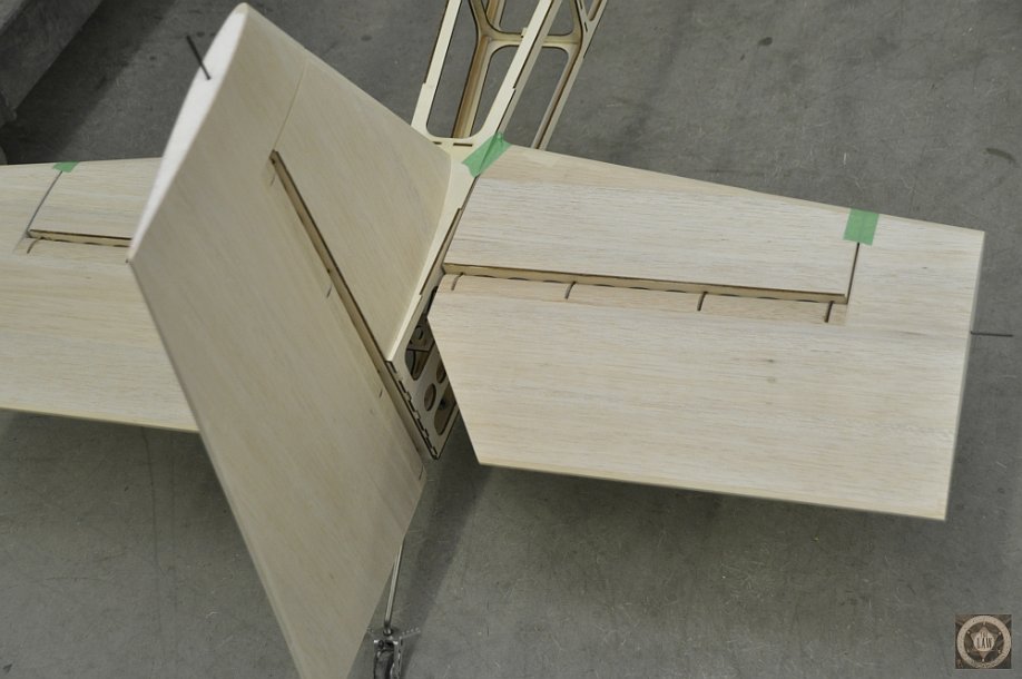

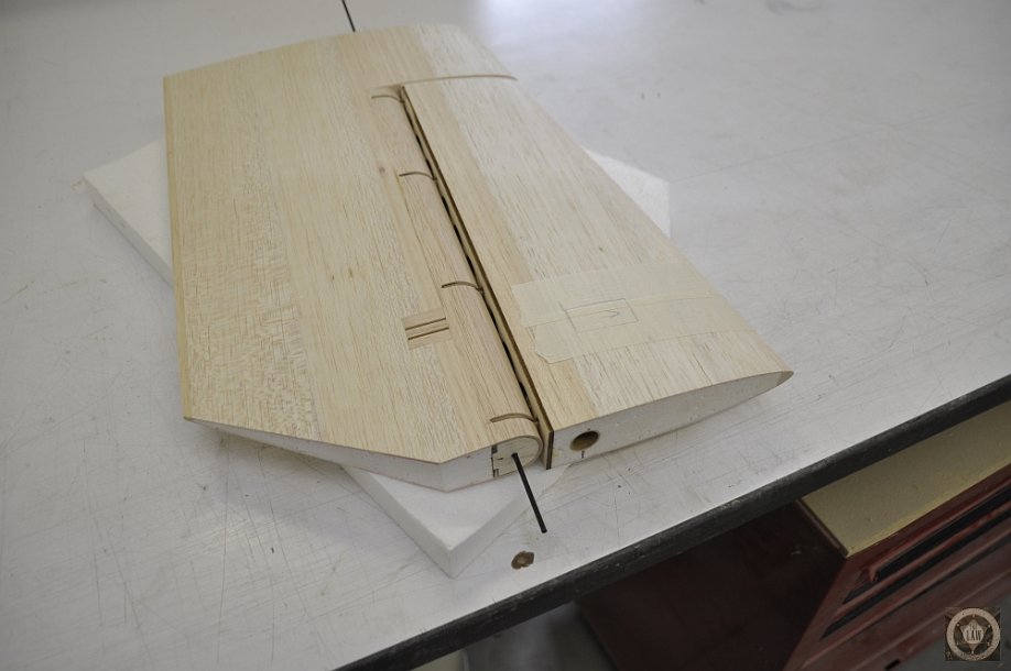

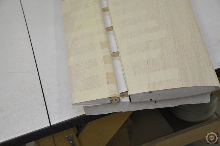

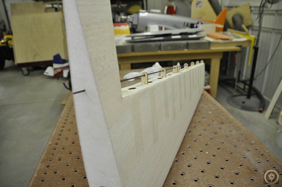

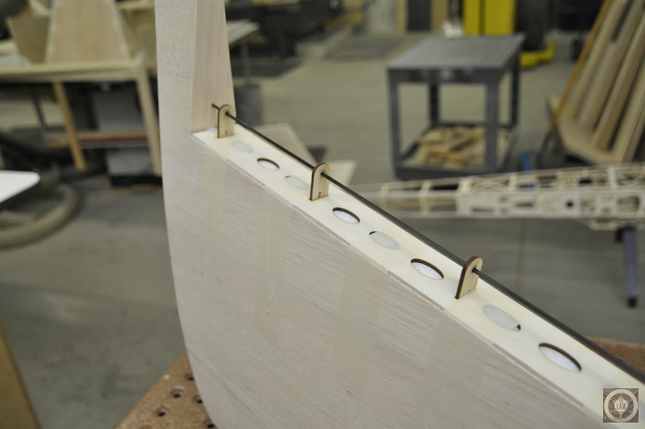

Closer, got the stabs hinged except the overhang on the stab part. Have to wrap up some work and I'll try to get the ailerons done tonight. They are a little more complicated with the split so we'll see how it comes out.

Terryscustom
Sorry taking quite a bit of thread space for the pocket hinges. I will offer them as an option after a year of testing but the MXS is actually designed for standard hinges and kits will have dimensions for their installation. Pocket hinges require 200% more accuracy and thought so I would only sell that option to an experienced builder. After flight testing we should have kits available for the MXS-ST by late summer for your next building season pleasure:way_to_go:

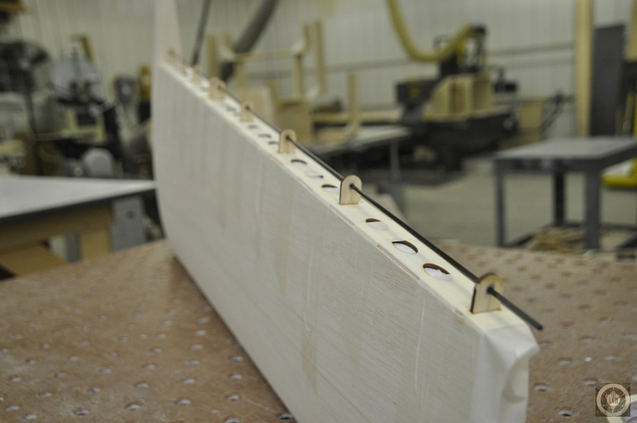

Terryscustom

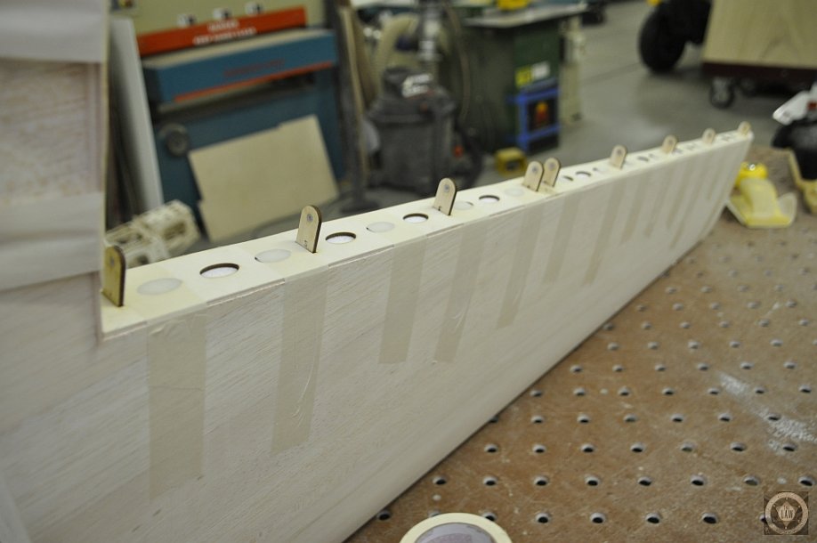

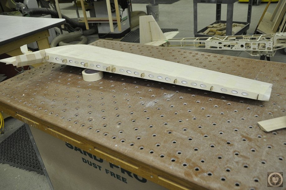

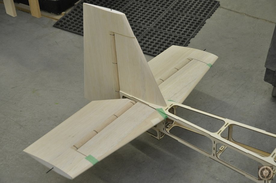

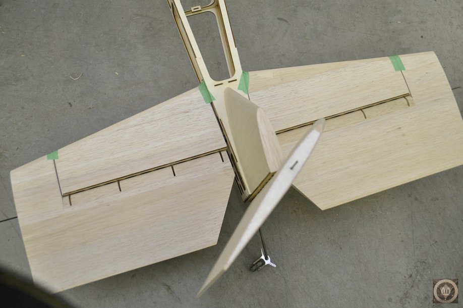

All surfaces are glued up, just need some end caps and the little overhang in front of the radius along with some tri-stock. I'll get it mocked up tomorrow but right now airplane working time is looking minimal in the coming weeks so I'll have to tackle a little at a time.

Terryscustom

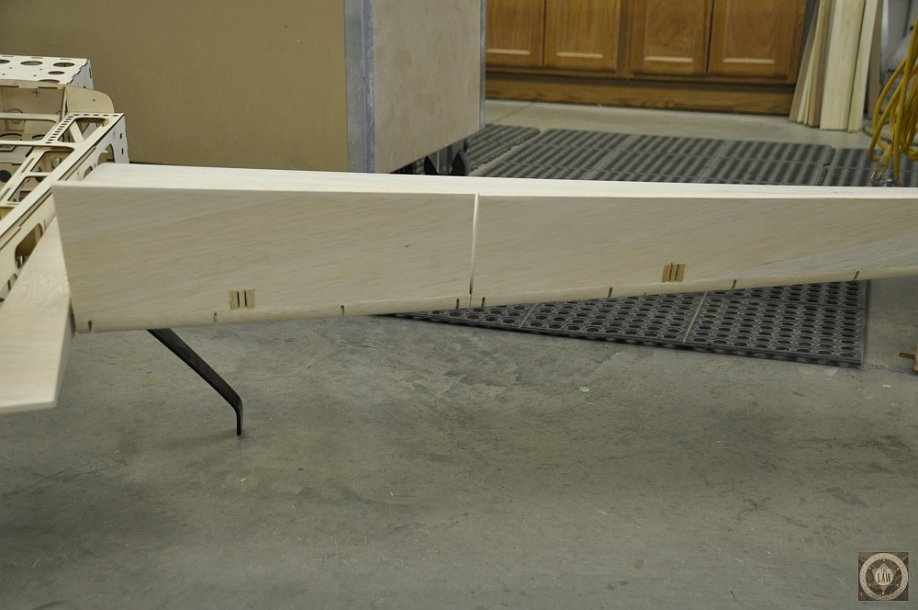

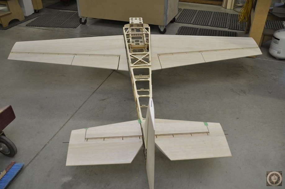

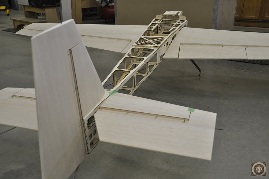

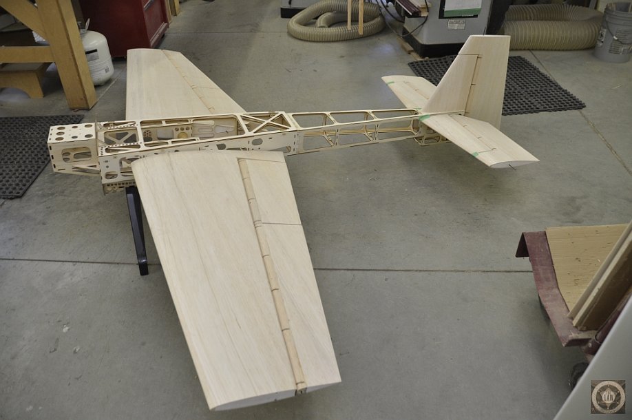

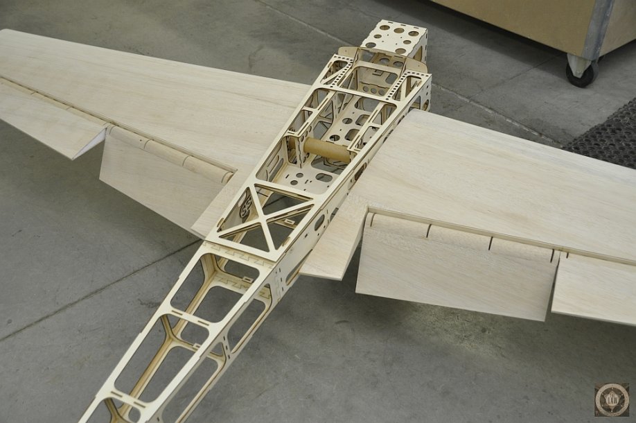

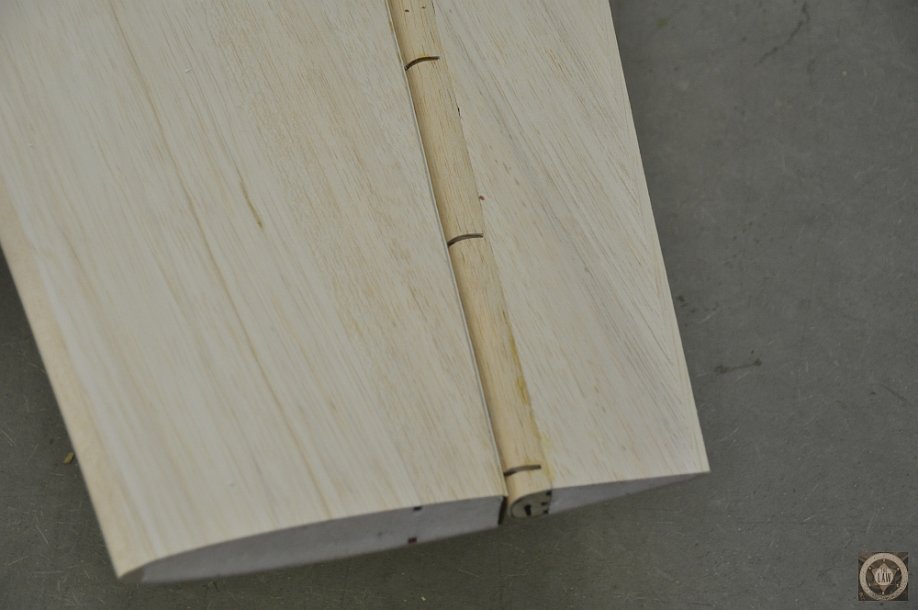

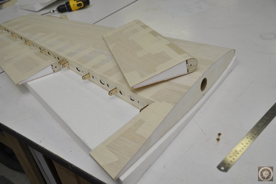

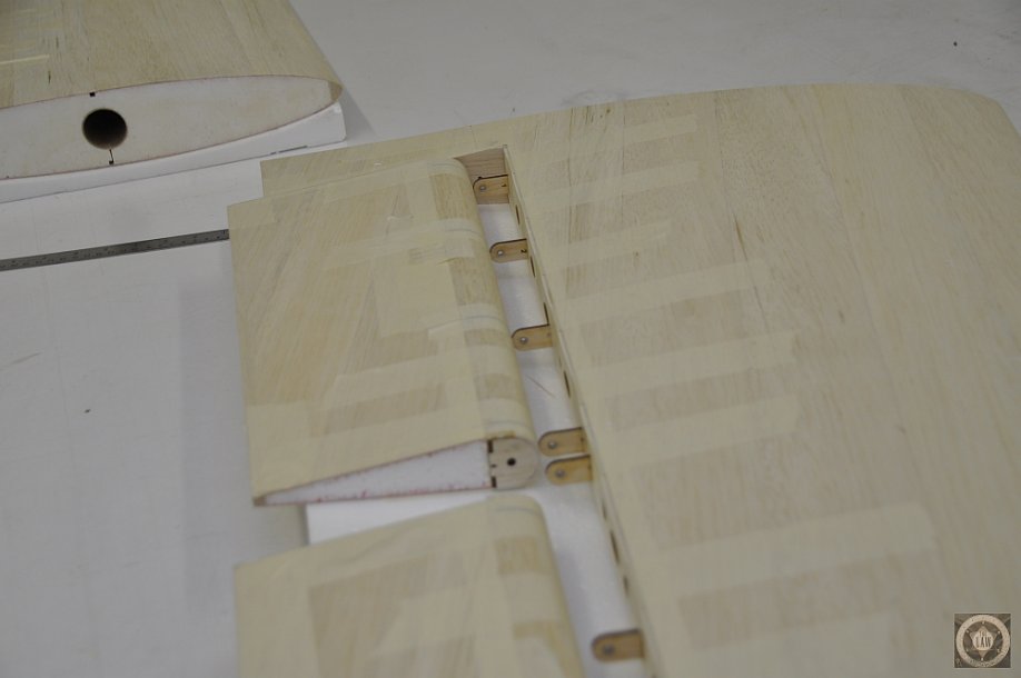

Took a few minutes and test fit the ailerons. Just need a couple hours for some final sanding and some end caps and they are complete. Thanks for your patience while I try this, the pocket hinges has been an engineering challenge I've wanted to tackle for quite some time. I am pleased to say that everything is working out as designed, the ailerons are playing nice with each other and this will be a cool scale detail for this plane in a couple months.
Looking forward to getting back to working on the rest of the airplane now!!!:fist_pump:. By the way is it just me or would this not make the most badass ugly stick ever if I just covered it now? Maybe next time....
