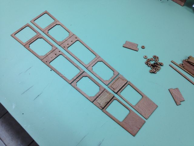

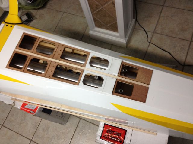

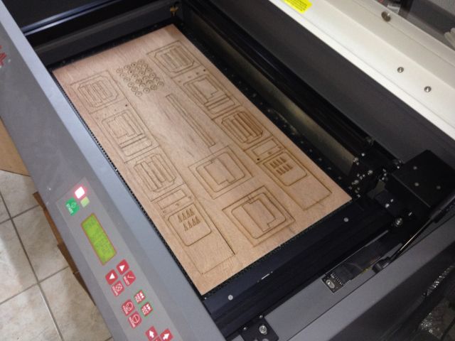

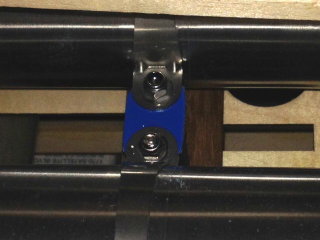

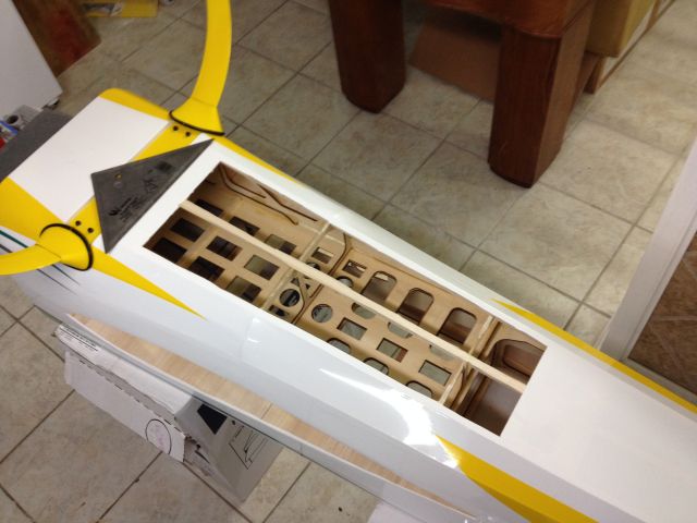

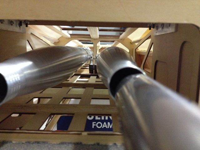

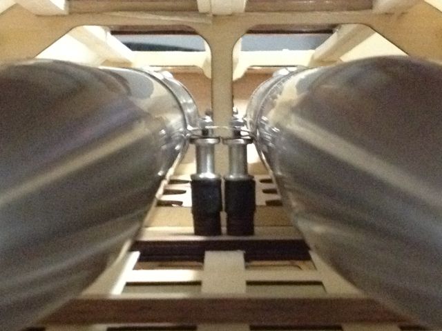

This was more than just last night, but... First time I have tried installing canisters, using RE3's with the Comfort mounts.. as others have said, these mounts can be a challenge to install. After looking at the space and scratching my head for a day or two, I decided to just open up the bottom and give myself a little more access to work with.... measured everything up, did a little cad drawings, cut out some stuff on the laser and it actually fit ! mostly.. one mistake is I left the comfort mounts a little too close together.... so, I cut a little spacer to help hold them apart...
Now I need to find a short exhaust extension that fits the ends of the RE3's... any suggestions ?

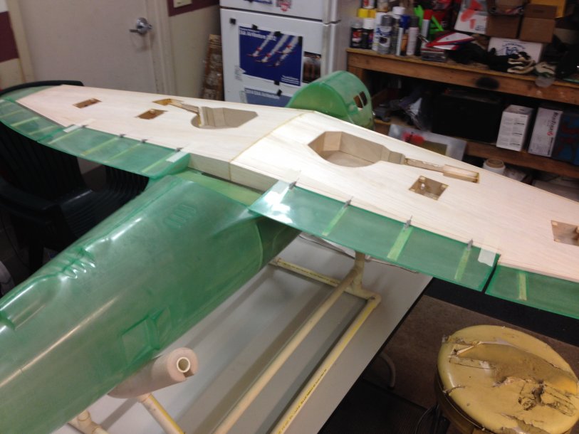

Worked on my jug and joined the wing today. Maybe some glassing this weekend!
