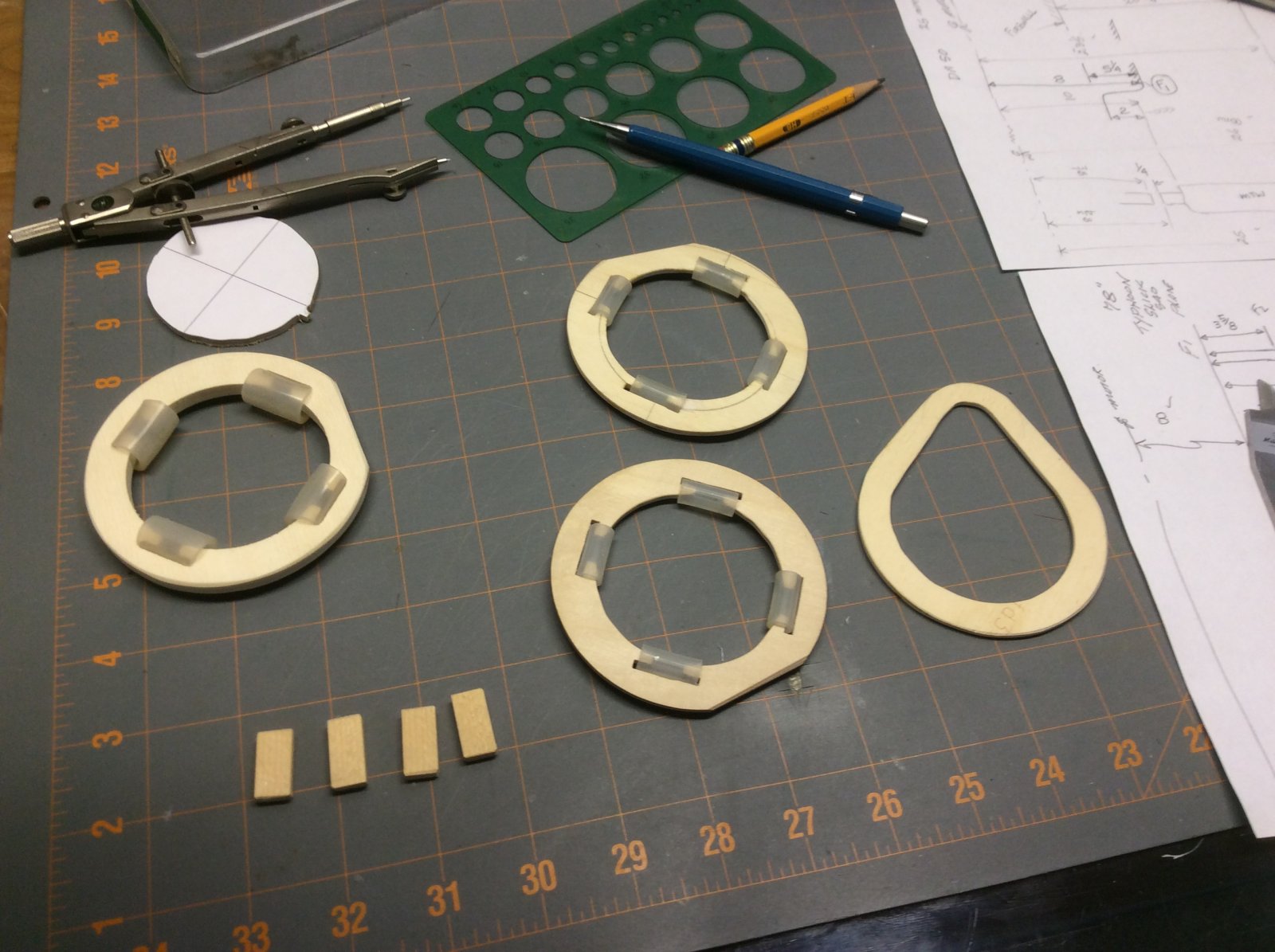

Did a quick check to see how well the canister will fit. Well the plane needs the first 5 bulkheads modified and then reinforced to accommodate the canister. And new supporters made. So start these changes today. Man it would be nice if they would sell these kits to us not built. Just give us all the parts covering and what ever else. Or do some small sub assembles eg stabilizers, motor box wings and rudder. Ok stoped complaining.

No pictures yet busy making canister mounting plates. Will have to cut out some bulkheads and cut open the bottom of the fuselage to get my hands into the fuselage to make the changes. Man it is hard to take a blade to the bottom of the plane to cut it open when it is all nicely finished, but I have no option.
Well got all the parts made up to support the canister. No more excuses to postpone to cut the bottom of the fuselage out.
Next make a layout to make sure where the canister sticks out of the bottom of the fuselage.

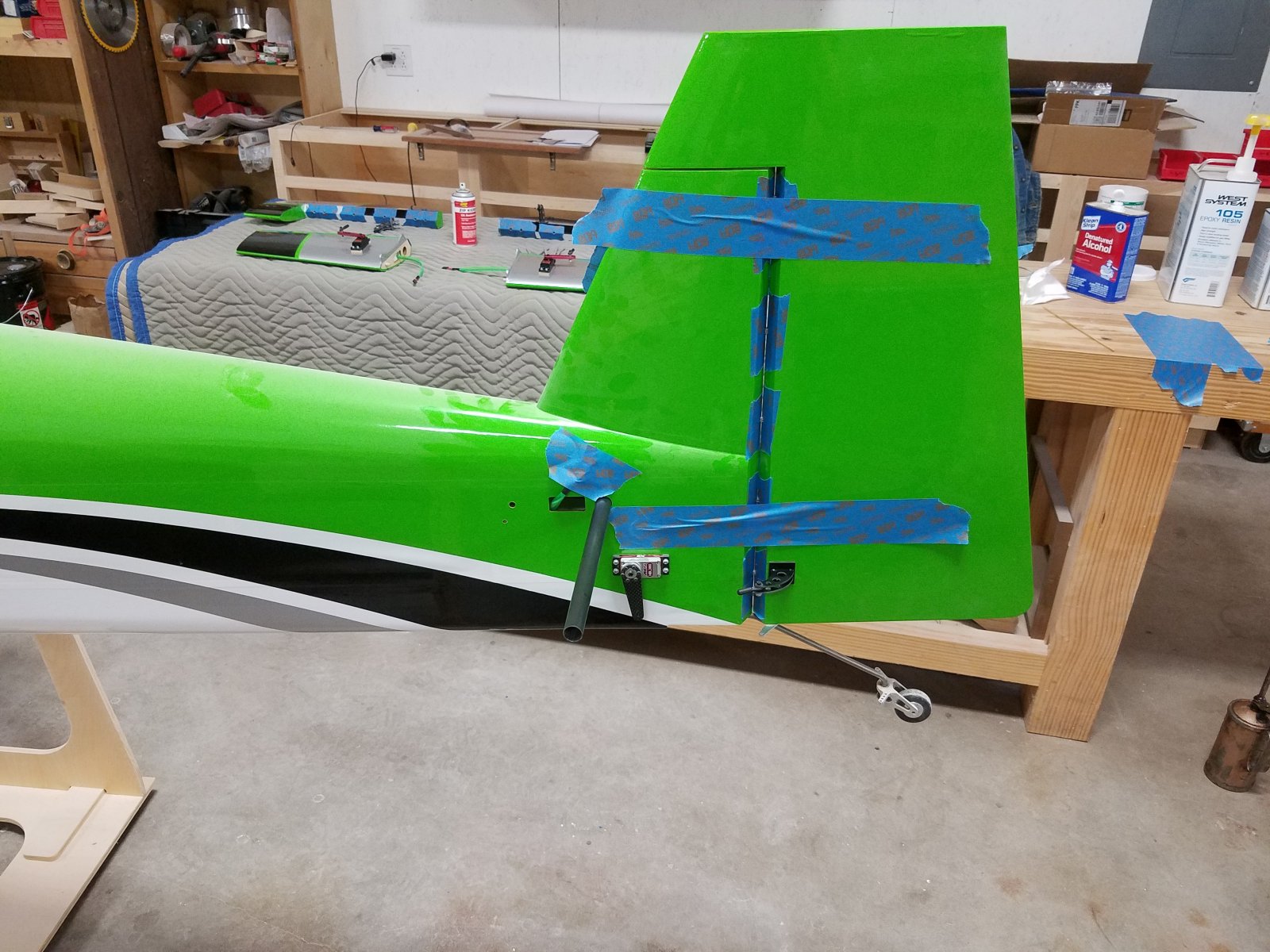

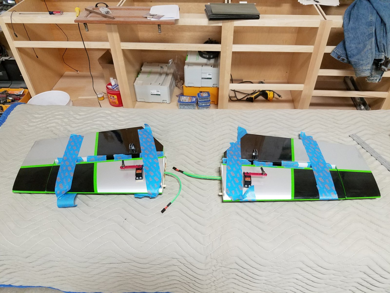

I got all the hinging done on the Viper. I am glad that is out of the way! Very time consuming and kinda messy,even when you try to be as careful as you can.
Hi how are you doing , have not worked on my ViperST for a while. Put a couple of ARF together and with older radio gear that I had laying around. The Viper is essentially built just need to paint the cowl and pants. Get some radio gear and put it all together. Hope to get some good deals at JoeNall.
