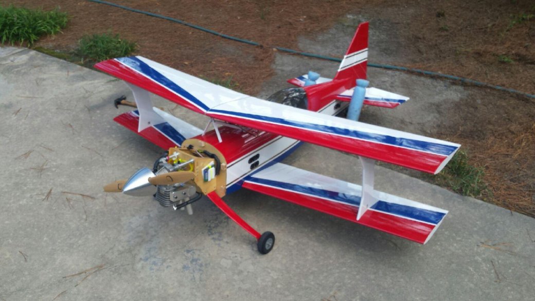

Finally got the radio, trim, expo, etc done!:D Fueled up the DL 50 and did about 8 flips and it barked to life. Took off the choke, 3 flips and she came to life!:woohoo!: About a half turn rich on the high speed and I am getting 6,900 rpm on the top end and a little lean on the low end and getting 1,600 on the idle. Very happy! Plan to taxi test on Thursday if the weather cooperates and if I can get out of work in the late PM.:ninja::LOL_gif:

Cool!!
That a temporary mount job on the landing gear?

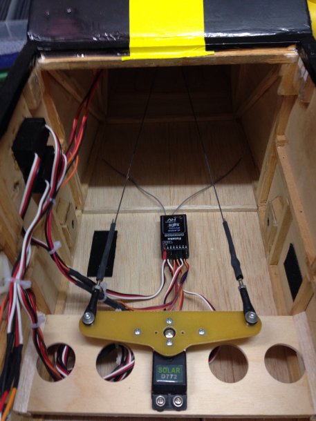

Well the cap was hanging a little tail heavy when I balanced it and was gonna have to add some weight to the nose. Who wants to add weight. I just relocated the rudder servo from the tail up into the fuse. I put it as far forward as I could so it's right up behind the tank tray. Cut a few lightening holes add a little glue shake it up and voilà we have a rudder tray. Best part I didn't have to add any weight.
Also sent some photos of the plane to Dennis at Carden. He was impressed and gave me a bit of info on the plane and of course I tried to convince him to bring back the cap kit. :)

Nice job bro! Looks factory.
