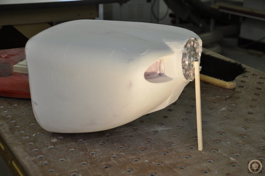

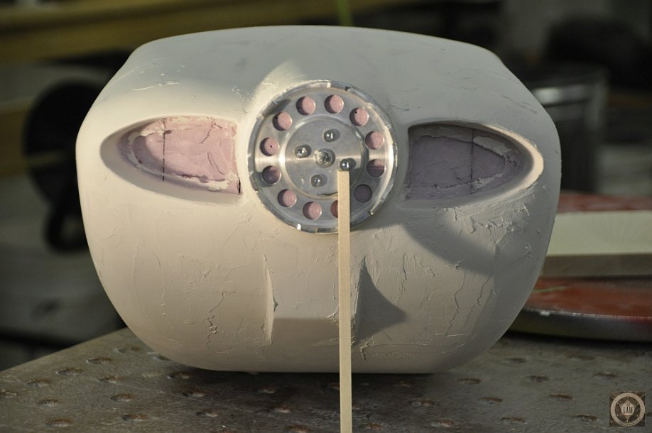

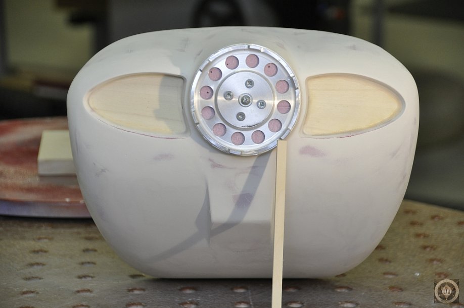

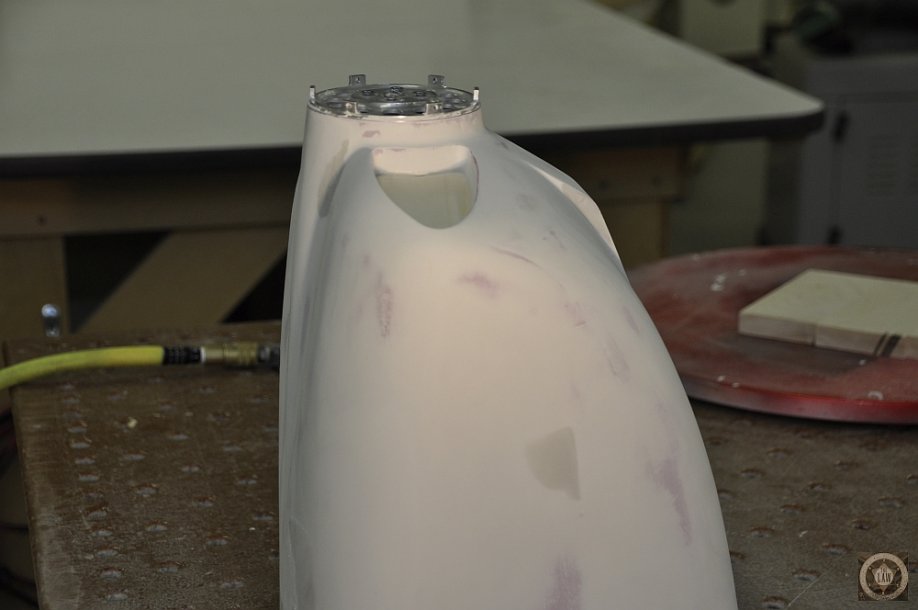

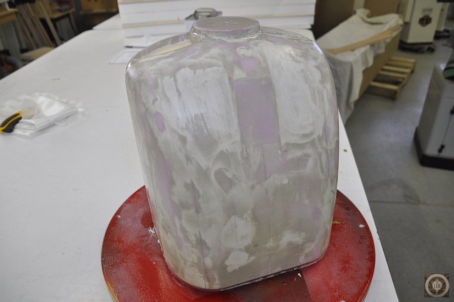

Getting closer. Tomorrow I'll probably be ready to go over it with some epoxy resin thinned with alcohol to bond all the drywall compound together. Then I can do it again with some fiberglass. Few layers of filler to fill the weave and I should be ready for first coat of primer.

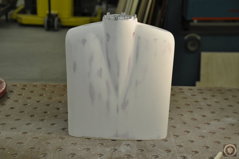

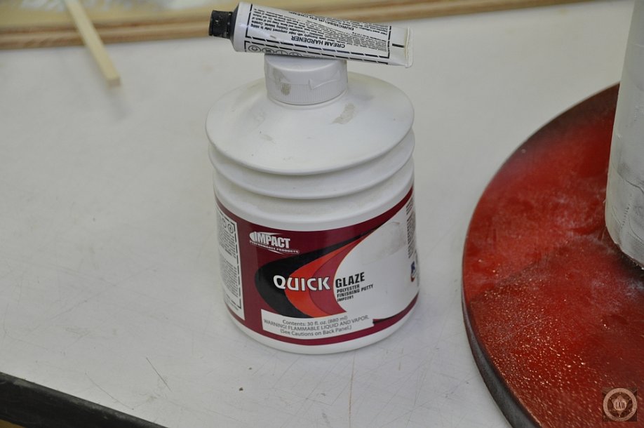

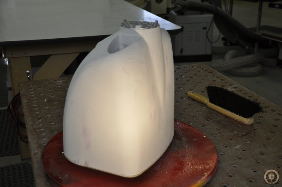

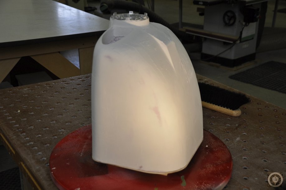

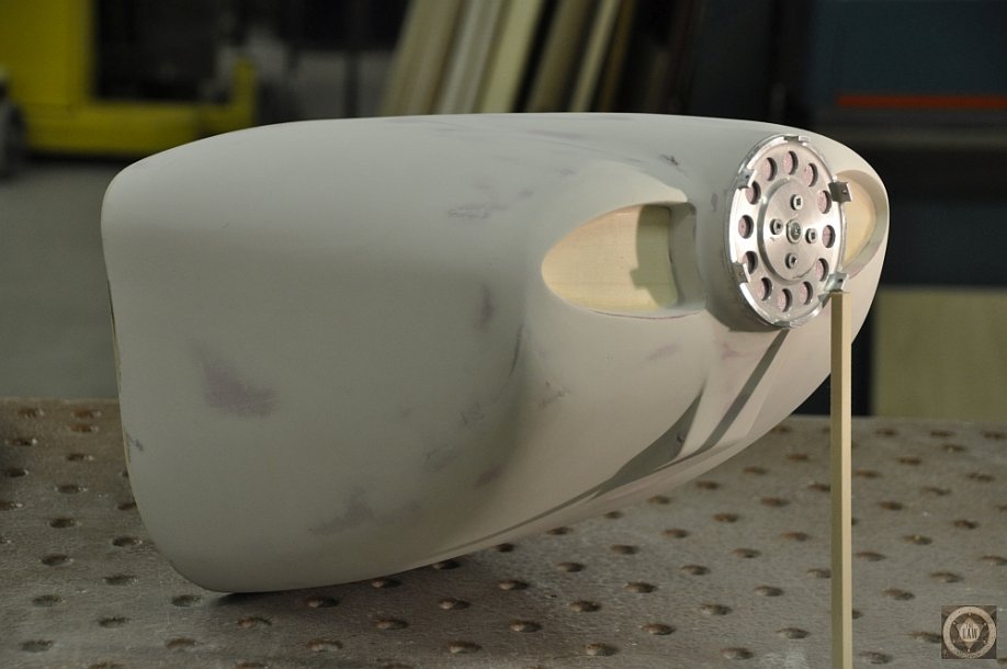

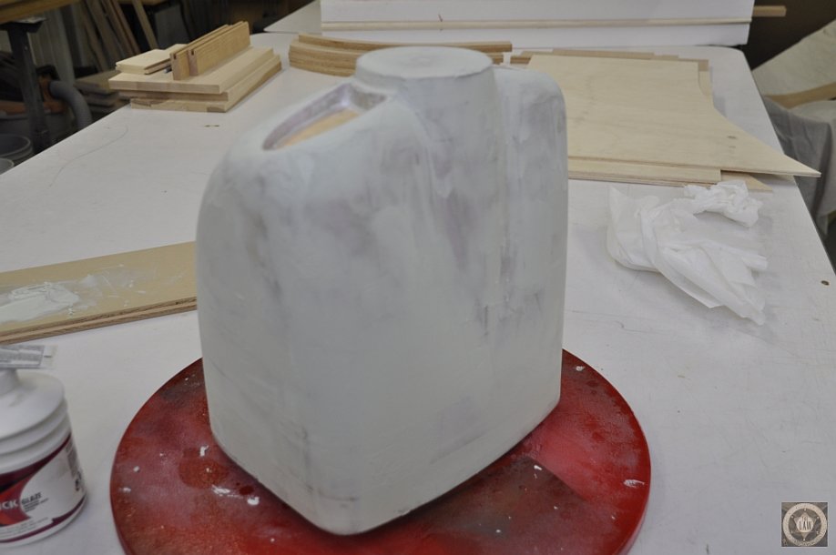

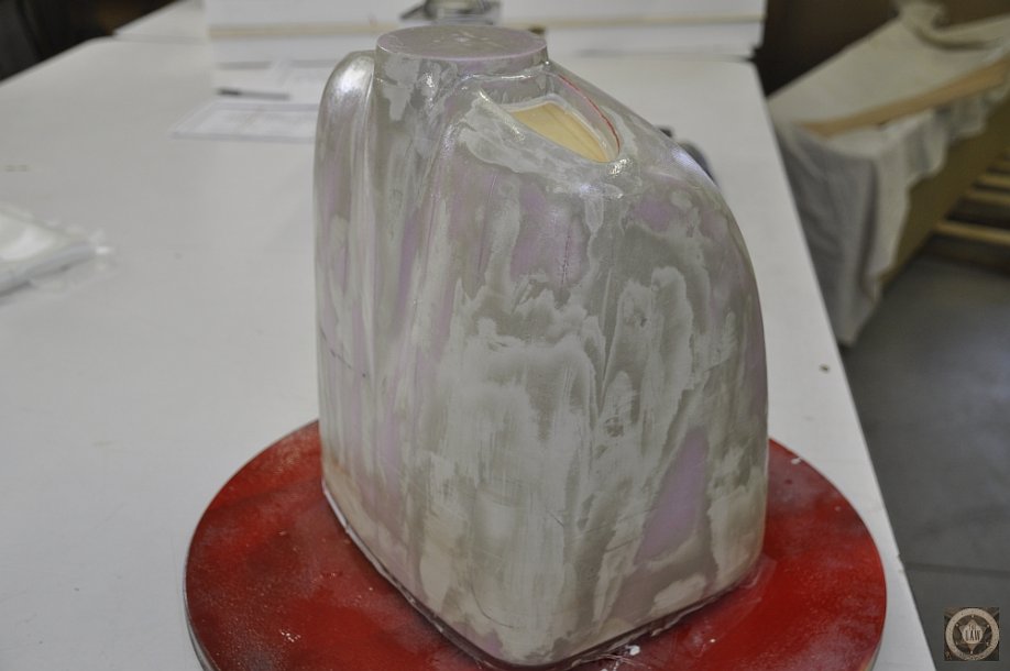

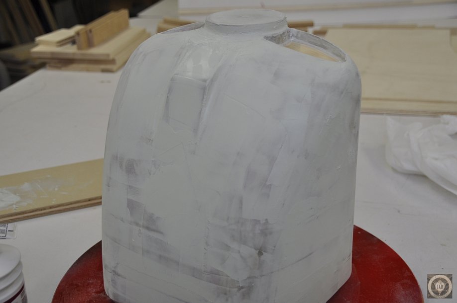

Resin set enough this afternoon to knock it down a bit with some sandpaper and apply some glazing filler to fill the gaps and overlaps of the glass. Will sand and then fill / sand / fill / sand some more tomorrow.
