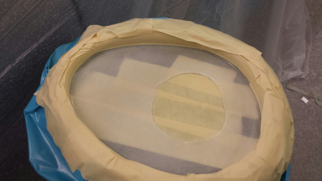

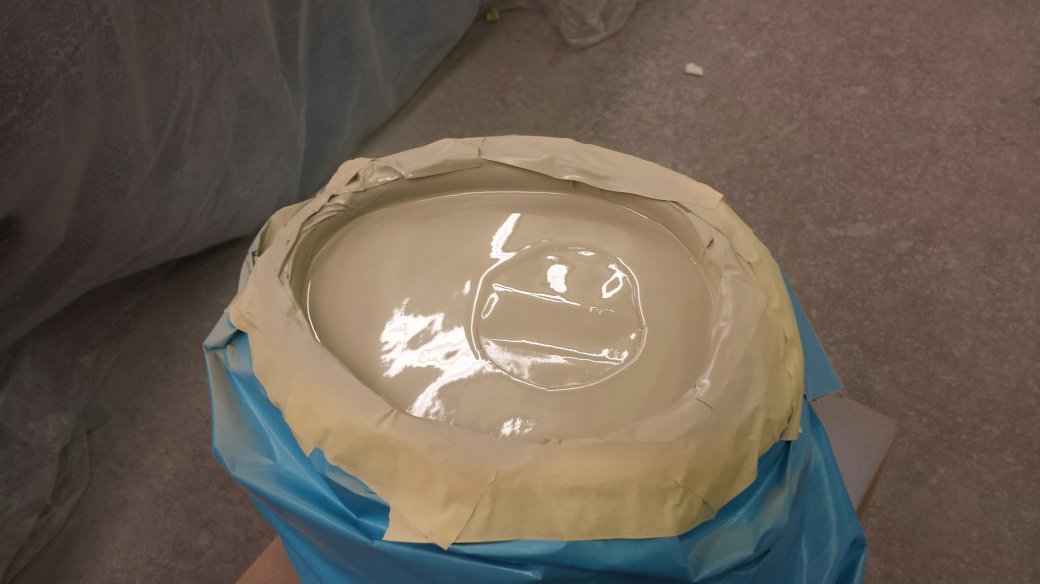

Terry and Rick, I was shooting some of the Spies Hecker spray poly this evening, so I sprayed a couple of coats on part of the cowl for my scratchbuild project as a test to see how it does over Epoxy Resin. I'll see tomorrow how it cured and let you know how it did.

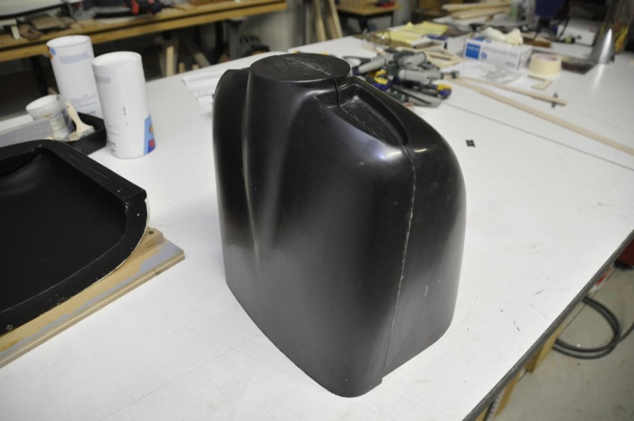

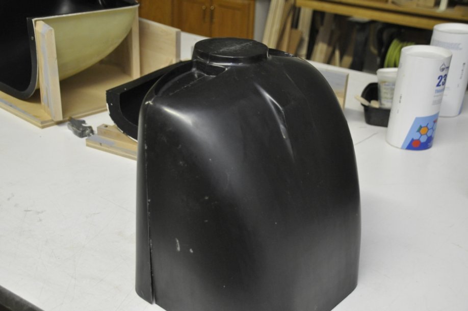

Cool Jetpainter, interesting stuff. I wanted to make myself a couple more cowls before I hand the mold over to Fibertech so today I tried a couple. Fist one was laid up with satin cloth, and it was immediately noticeable that it did not have enough structural integrity so I pulled it from the mold early. On the second one for today I went back to my old tried and true process but mixed in a little powdered graphite to give it a black color. This will allow me to really see the surface fresh out of the mold.. I've been sanding a little and cleaning up the mold with each pull. I'm super super happy with this right now. Very little body work to do before painting.
