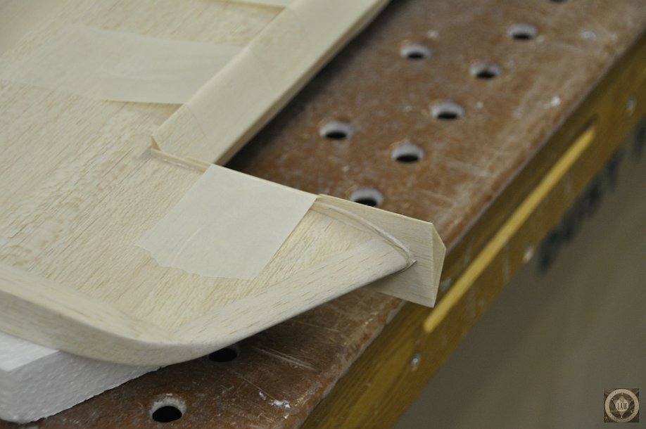

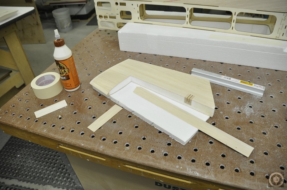

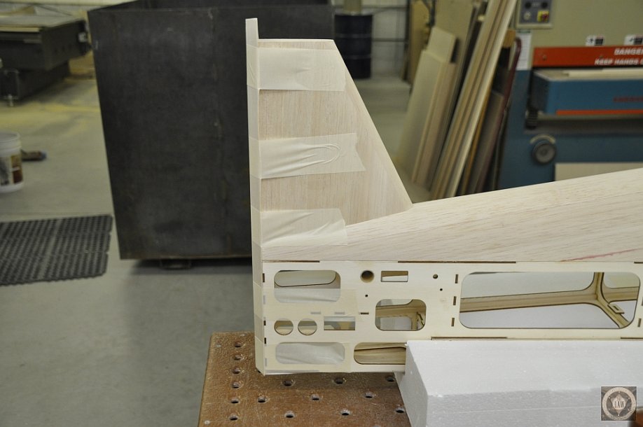

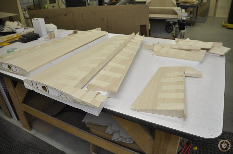

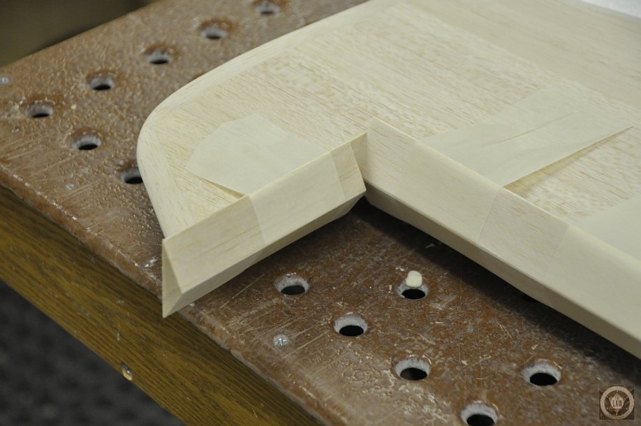

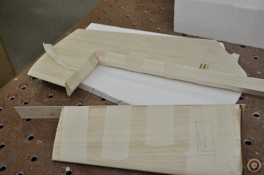

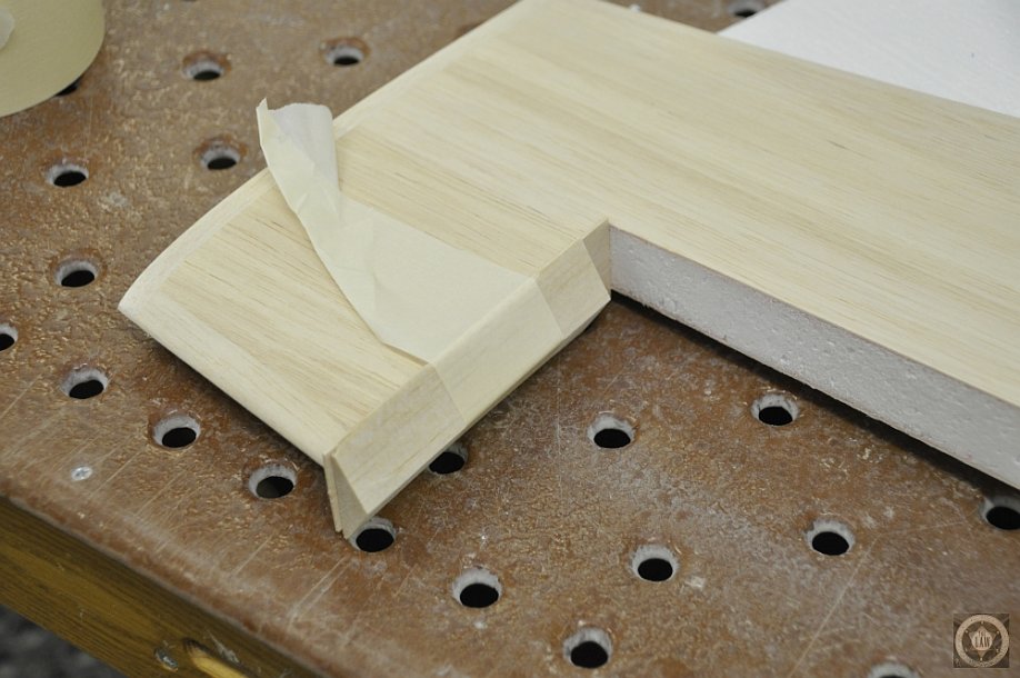

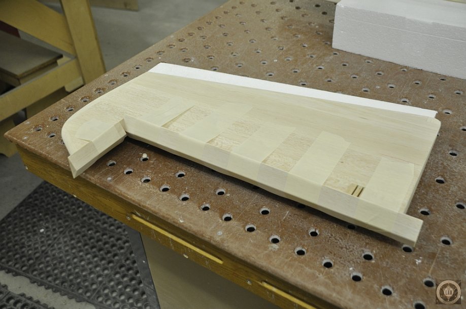

Got a few more things done. Most of the rest of the caps are on and hinge stock is glued. To glue on the tapered stock I apply glue to the foam and spread evenly. Then tape each end making sure that the hinge stock is centered. Next tape the center and make sure that's centered. Then tape half way between those taped areas, and then once again between those. This will ensure that the stock is straight.
