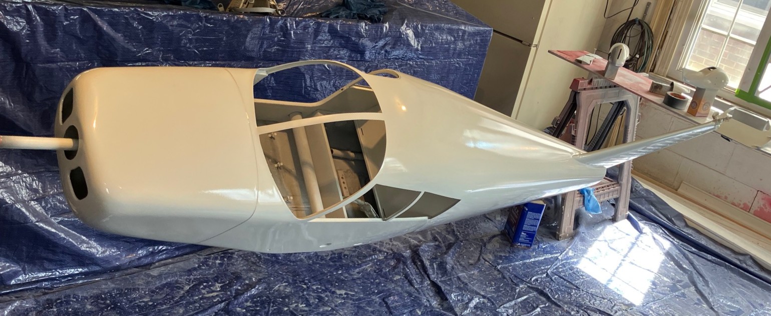

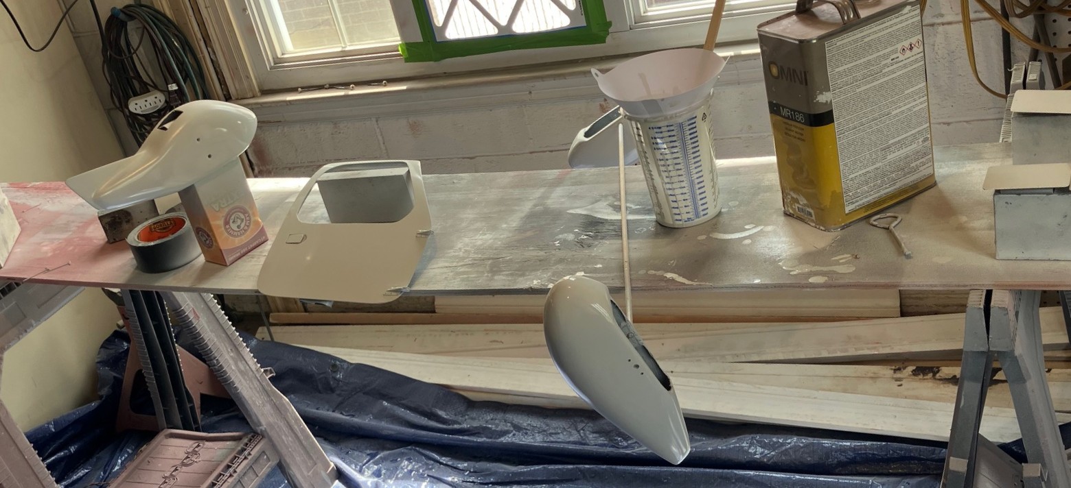

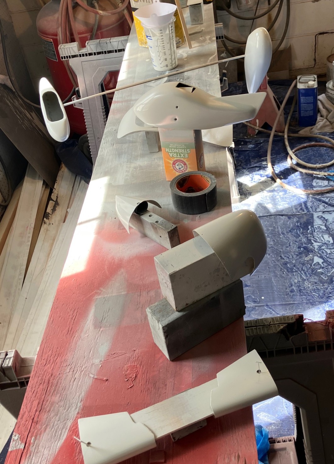

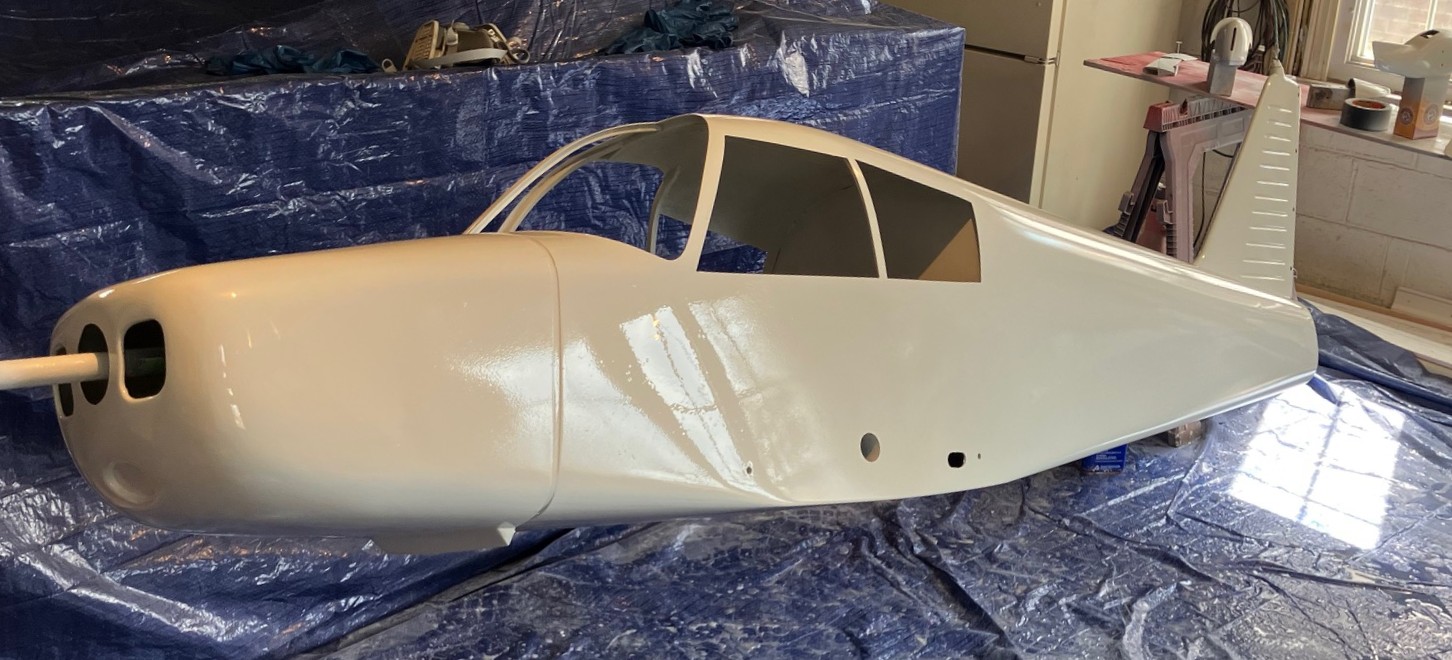

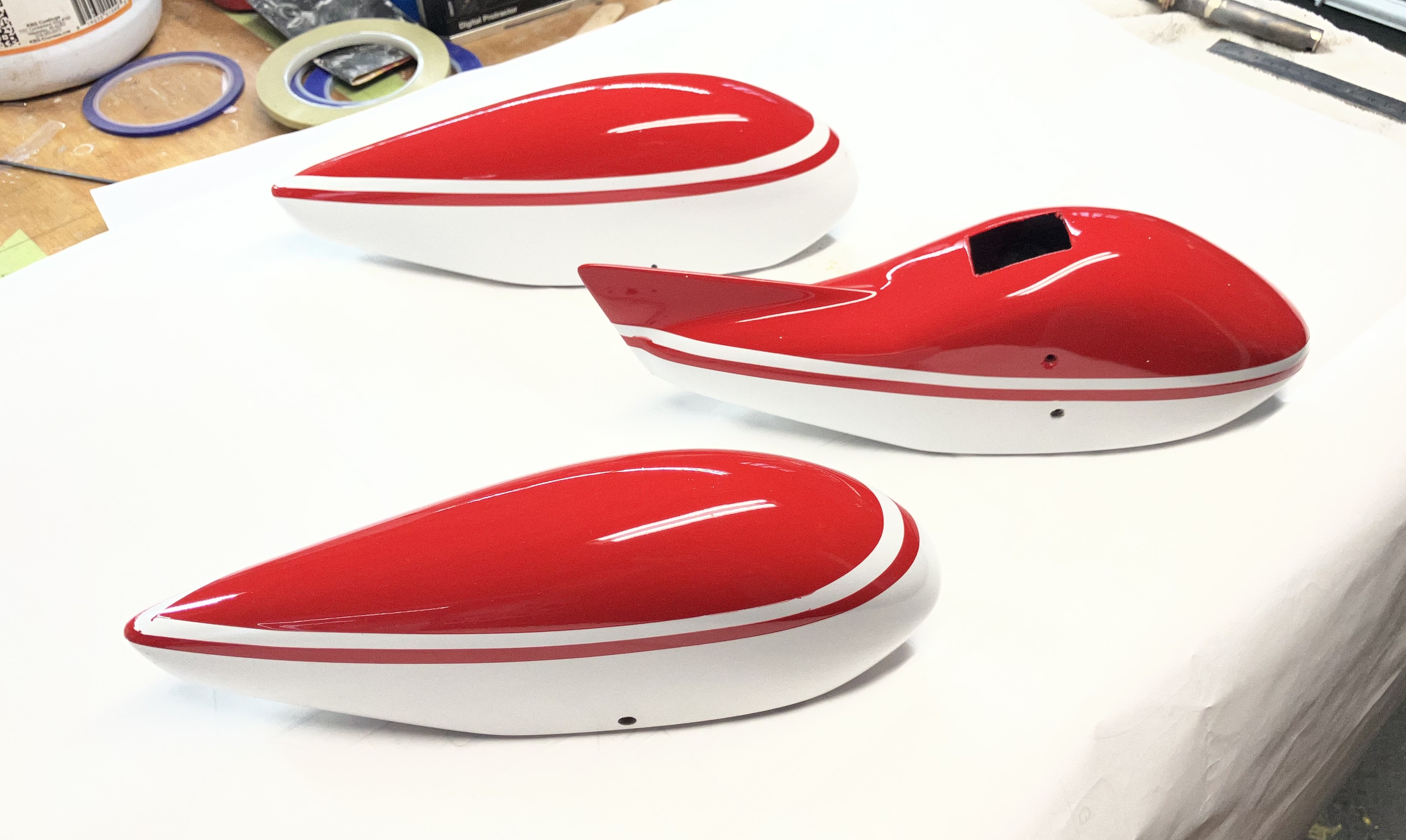

Weather was on my side to day, put the white to it. One light coat of white urethane sealer and one coat of white acrylic enamel with hardener. Will mask the red trim in a few days. Thinking I will do the wheel pants first since I need to mount them on the plane to lay out then do the fuselage separately. It is back in the 40's today

Nice colour red I like it nice and bright.Not having a good run, shorted out the USB cable on my laptop while working on an Arduino board, bought a new laptop. At any rate the parts came for the compressor and it's back running.
This was my first real experience using Mason paint and I am quite pleased with the results. Started laying out the fuselage trim however the weather when north and Monday is the next painting window so I plan to start masking on Saturday. I have the centerlines laid out with a laser and made up a 75" straight edge from an erasable poster board from Staples that I picked while buying the new laptop. I plan to use the straight edge to layout the long lines on the fuselage
