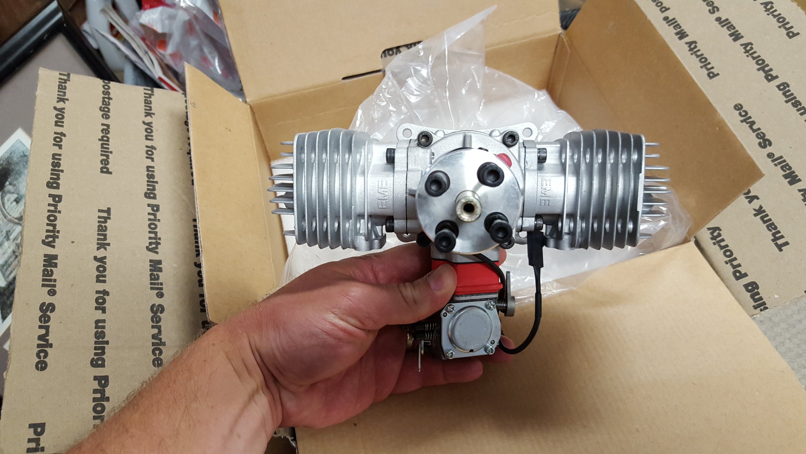

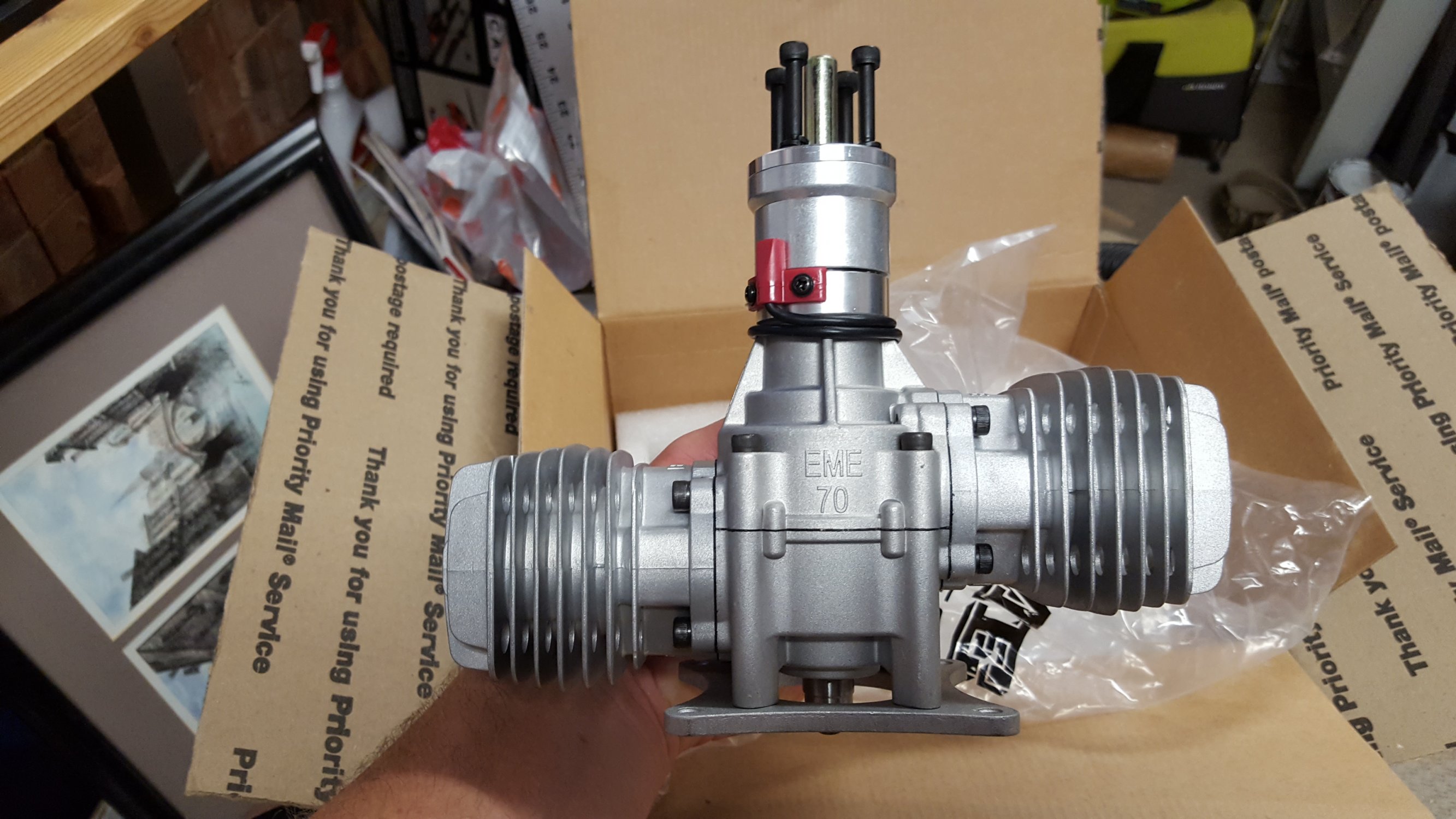

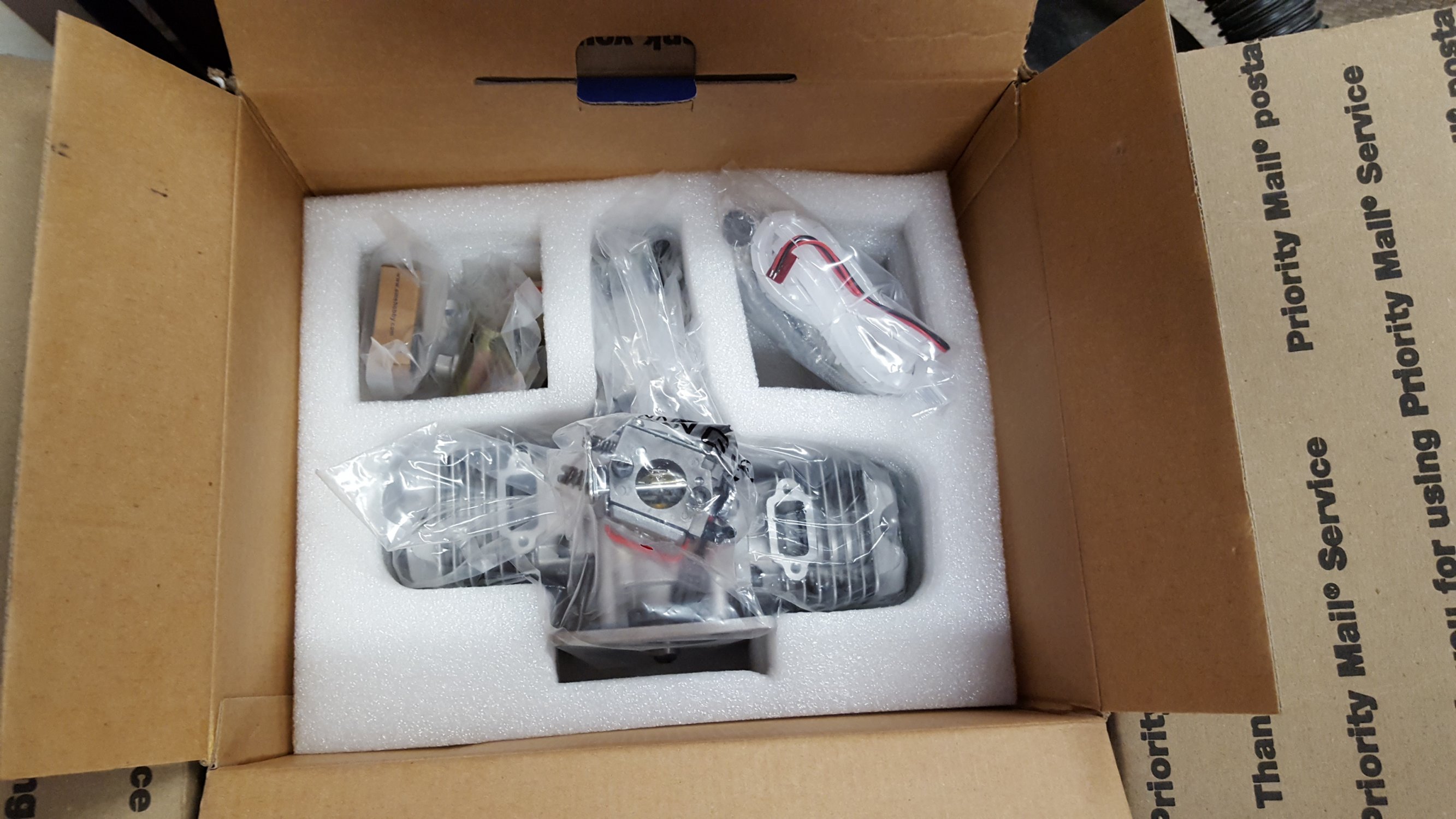

I was having problems with the DA 60, sent it in, and $200 later I had a bad taste in my mouth from that motor. So I sold it and got an EME 70.

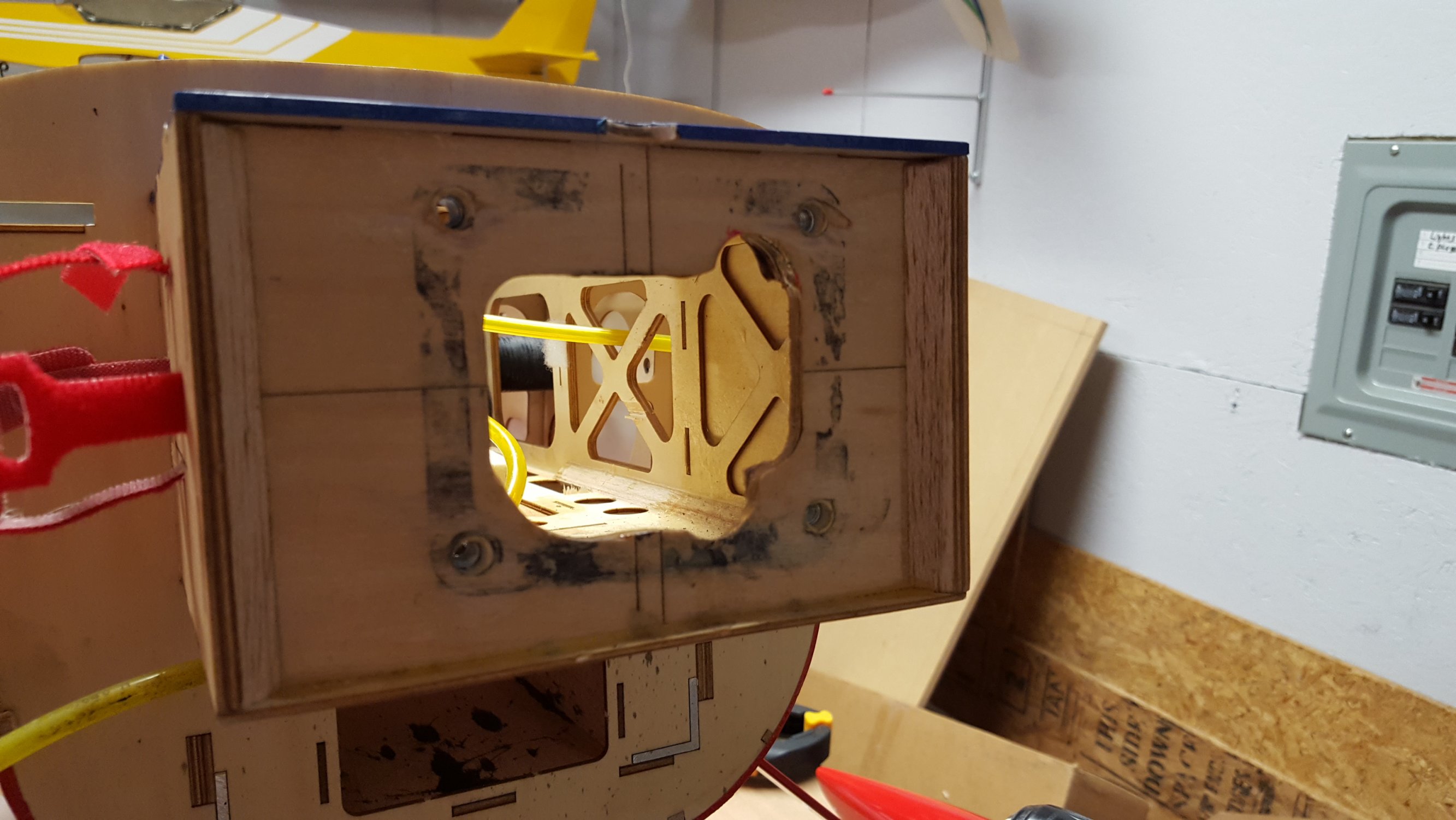

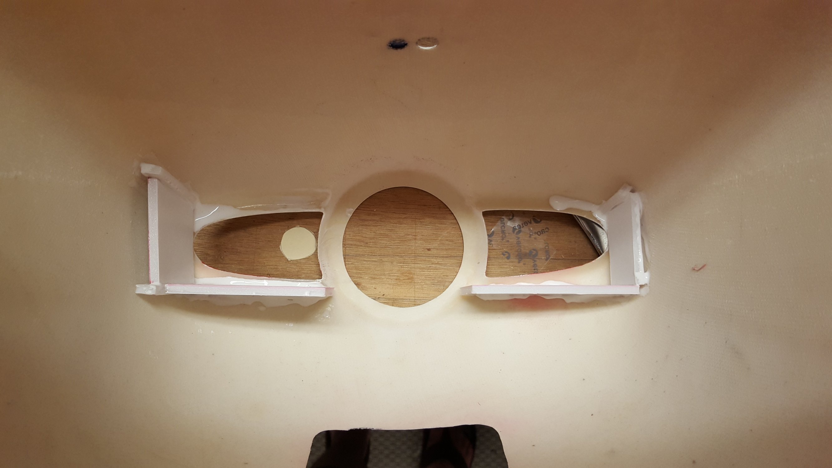

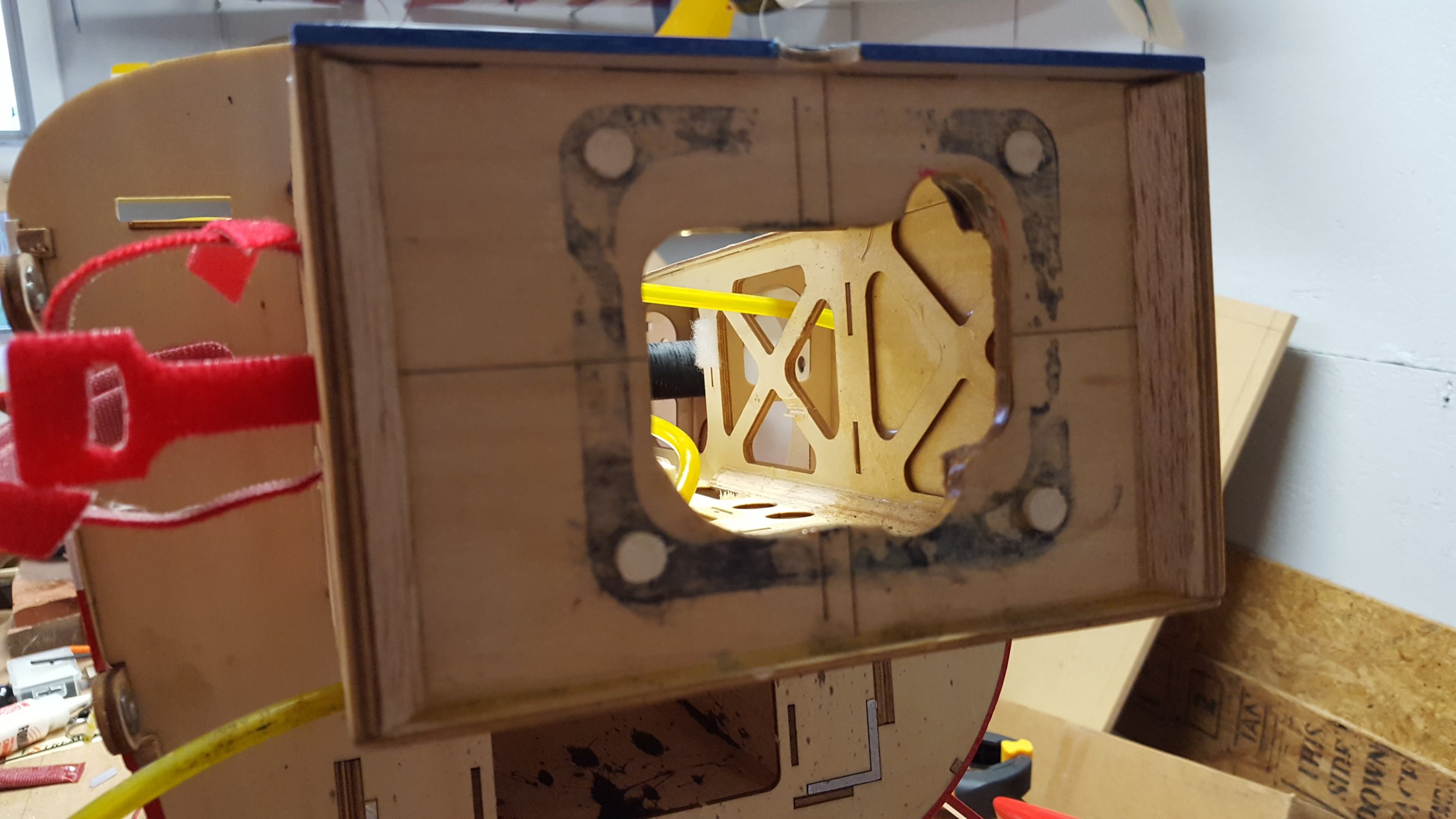

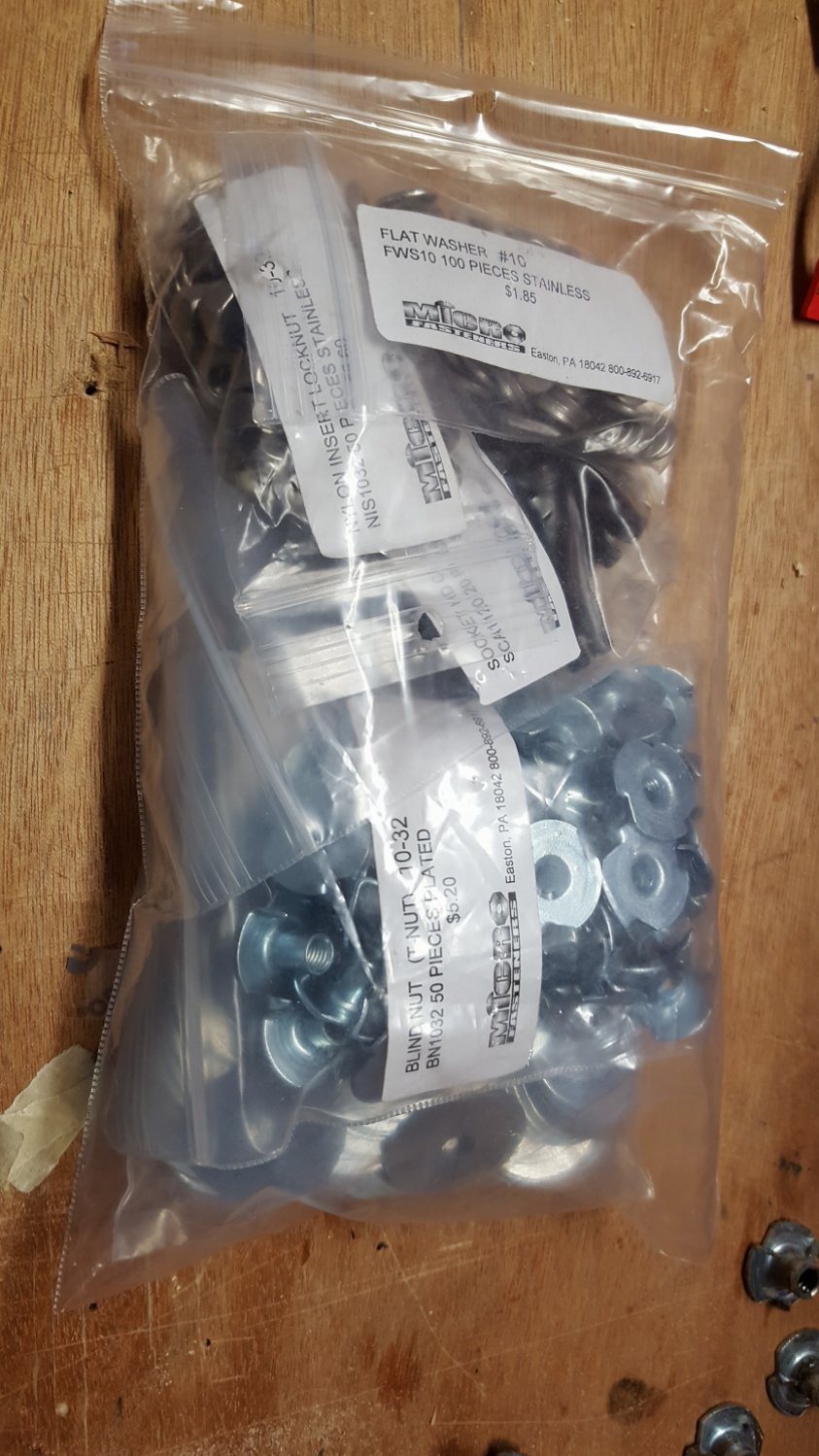

I got the old holes plugged up Tuesday night. My 10-32 hardware for mounting the motor came yesterday so I got the new holes drilled, blind nuts installed, and resealed the firewall where the dremel knocked away the previous thinned epoxy sealer sanding down the filler dowels.

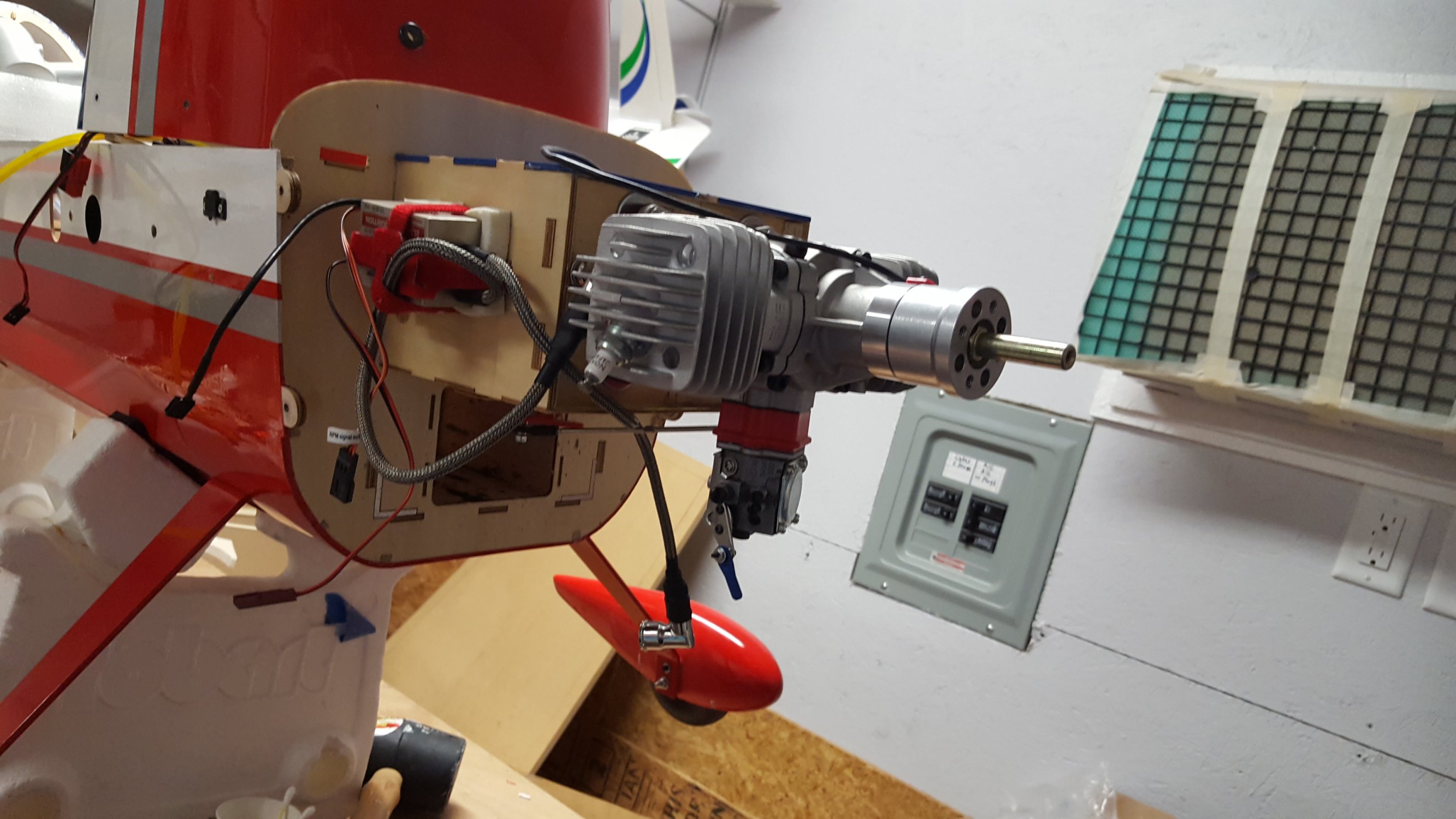

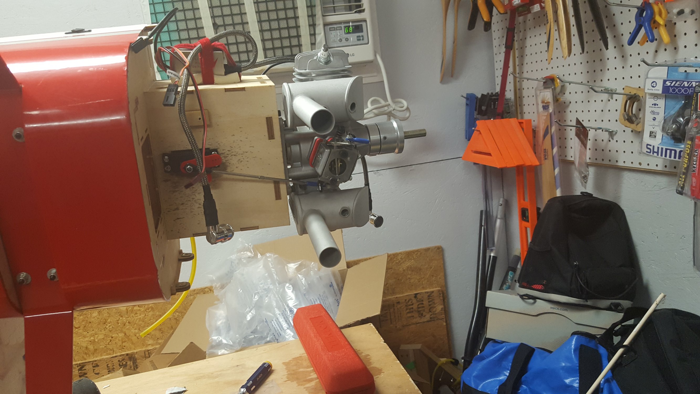

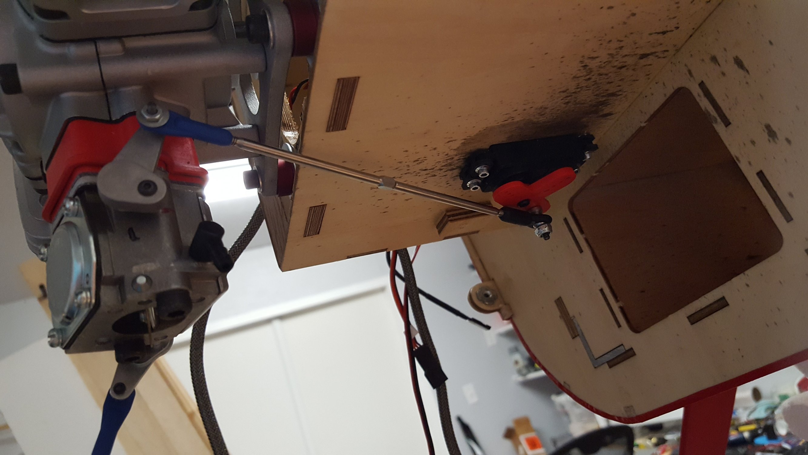

Nothing too exciting. I got the engine mounted and the throttle pushrod set up.
I also installed the spark plugs. I just did about 1/16th of a turn. What is everyone else doing?

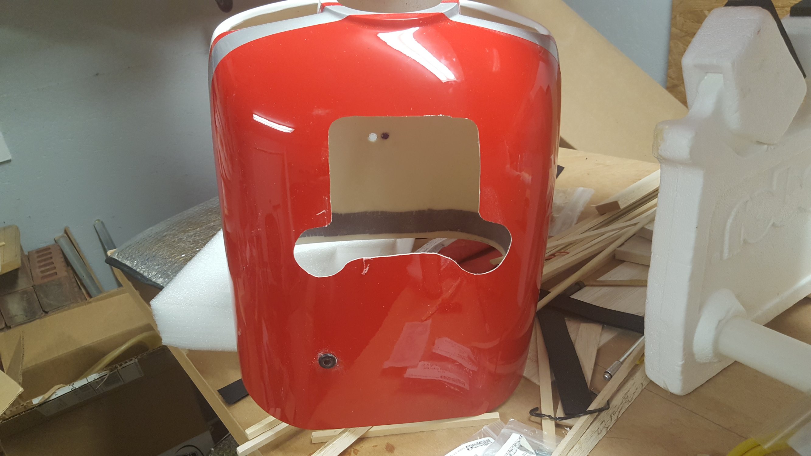

Next up is to cut the cowling for the mufflers. I'll probably buy another cowling but for now I'm just going to use the old one.

I got a crude cutout for the mufflers in the cowling. If I need to adjust it, I can make the modifications with the mufflers on.
