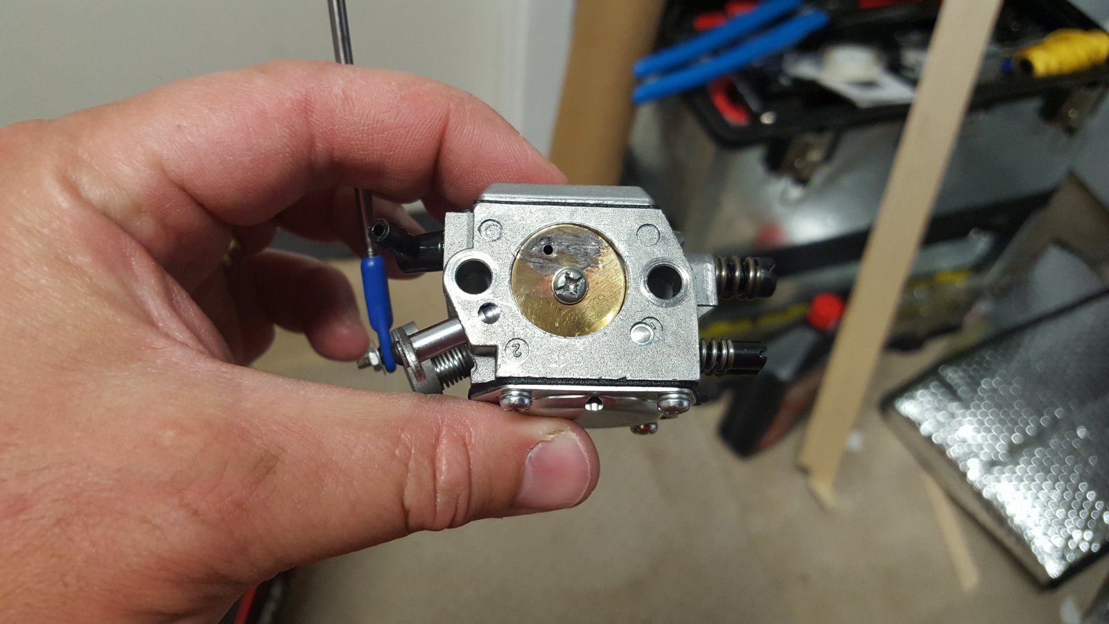

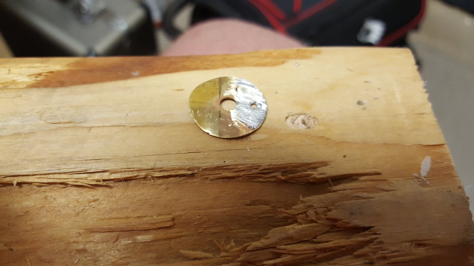

Both of his run damn good. The only thing I don't like is you have to hold your finger over the carb plate to get it to draw fuel. I may try covering the hole with silver solder and see if I can get it to draw fuel.

I still have to put my finger over the carb plate to get it to prime to start so I just fold up some paper towels and stick them in my pocket to rub my fingers on. I have a good bit of my shop packed up so I'm going to take the plane off the wall to do some more baffle work, adjust the throttle linkage (right now I'm at 30/130 but I wanted to fly it) to get better resolution, and then I'll see what I have in the way of carb choke plates that may fit and see about putting some silver solder or JB weld to close off and see if that can get it to prime fuel without putting my finger over the plate.

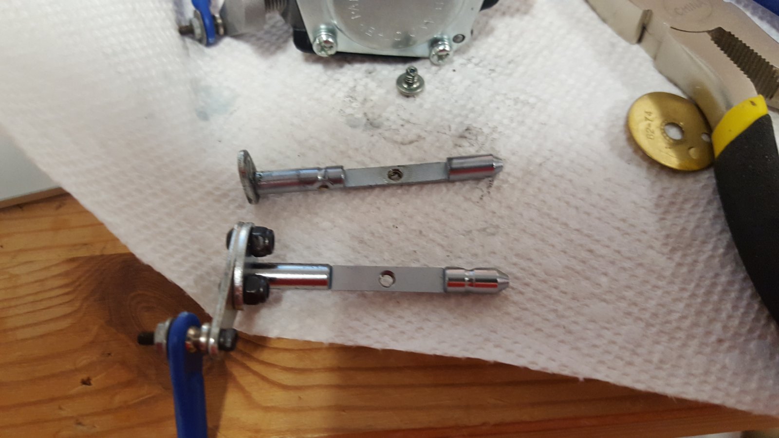

I also got some solder over the choke valve and now it draws fuel on it's own. I still have to flip it a good number of times before the first flight but it's not really any different than any other motor I've had. I also swapped out the axle that the choke valve mounts to and now I pull to choke and push to turn off the choke.
